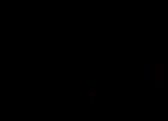

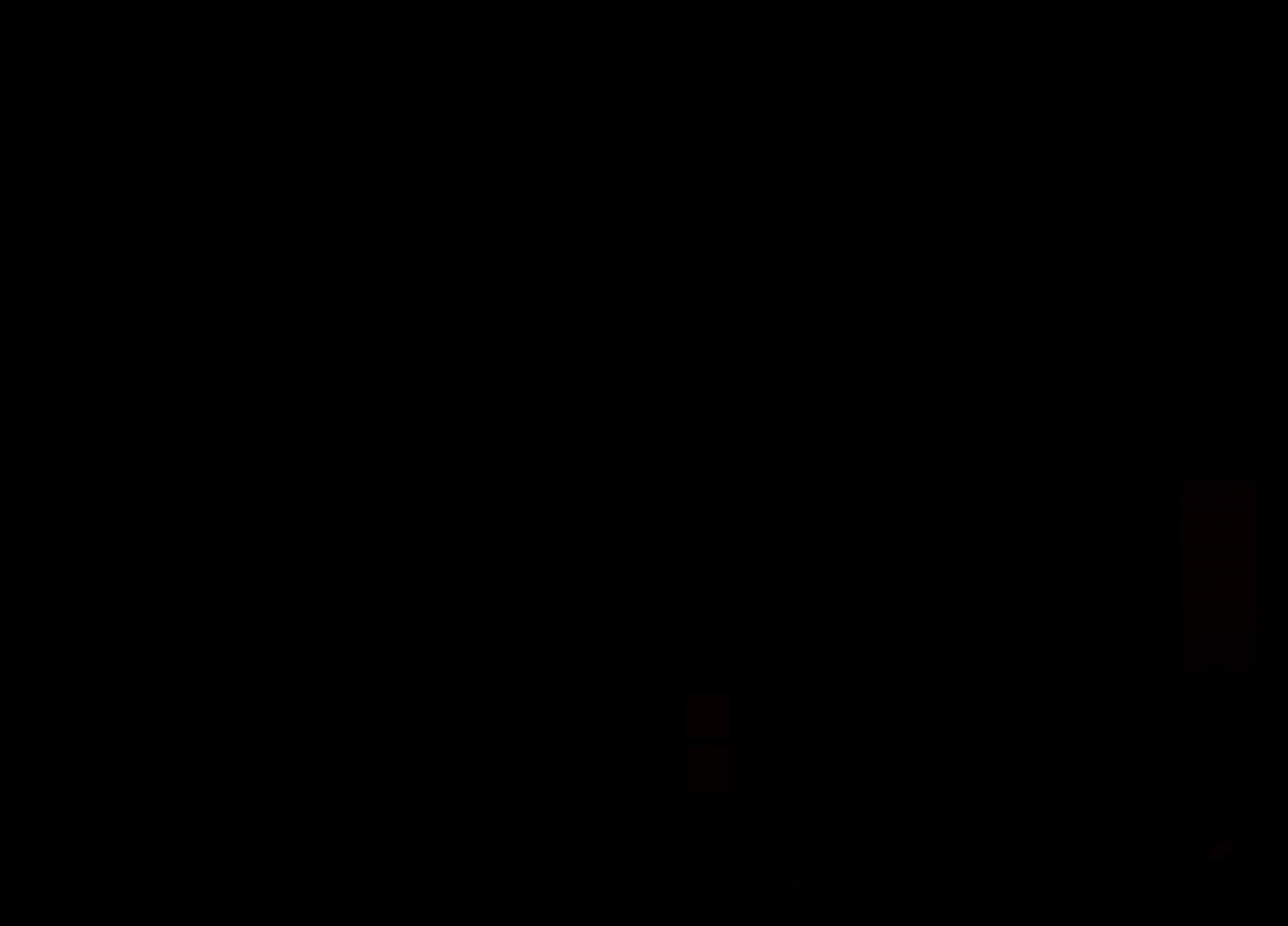

- Load a 24bit png
- Save as JXL lossless
- Close the file
- Load the JXL
- Save as png
- Pointwise compare the saved png to original file
I used the original image I mailed to you
(see viewtopic.php?p=180604#p180604).
You can save the JXL by yourself.
The diff file is included (try splitting it to the 3 hsl channels).
There may be a bug in the JXL encoder,
or in the decoder
or in both.
JPEG-XL lossless doesn't encode lossless

Re: JPEG-XL lossless doesn't encode lossless
I don't understand you.
What do you mean by "it's the same"?
Do you mean the jpx file produced by cjxl
- is the same as the original, or
- is it the same as the jpx file produced by xnview?
xnview is wrong in both cases, as the produced file is different than the original.
(Have you checked that? Pointwise difference; see attachment above)
In the second case cjxl is buggy too.
I am confused.
I am confused.
nji9
- Posts: 224
- Joined: Wed May 13, 2020 10:33 am
- Location: Germany
OK, I tried cjxl by myself for x86
https://artifacts.lucaversari.it/libjxl/libjxl/latest/
With option -q 100
It produces a file that is different (even smaller) than yours.
Decoded with with dcjxl to png
it produces a file identical to the original.
==> The error is only in XnViewMP
With option -q 100
