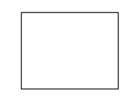

I have attached my own test image, a rectangle aligned with the horizontal axis, which can be used to see the effects of rotation and anti-aliasing when starting with a perfect rectangle. As in your test image, the canvas pixel dimensions are quite small, which results in the image quality degrading more rapidly than would be the case with larger pixel dimensions.
