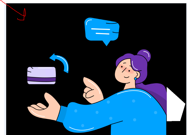

Hello - and thank you for your quick response. And I must apologize in advance because I mistyped my question / request. the converted tiff has a 'black' background - not 'blank'. I'm attaching the before and after files. The original is a PNG. The converted is a TIF. Lastly - I'm attaching the NConvert command I used.

Hello. Thank you for the quick response. I have now confirmed that the .png files do have a transparent background. I confirmed this because I moved the original .png to my local pc (which has a dark background) and the background was in fact black. There was not an issue using the converter.
Thank you for all of your help. I apologize that I did not make that connection earlier - and as you mentioned, no direct support for Transparency - which is fine because the actual files I will be receiving to convert would not have transparency. I was just testing on all kinds of files to determine if the program worked for my needs.
