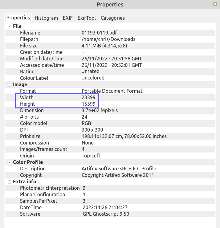

Your smaller 4MB PDF has very large pixel dimensions, so quite possibly your problem is the limit on the RAM addressable by 32-bit systems:
Opening and starting to work with it on my 64-bit system also resulted in a crash, but probably only due to insufficient free RAM with all the applications and files that I have open at the moment. So I can't confirm whether the PDF is valid, or might possibly have a separate issue, probably not?

@wfa: I have opened your file on another laptop with much more free memory, and although operations are very slow due to the large pixel dimensions, I have not encountered any other obvious issue.
I was going to extract the four pages and attach them for you in the expectation that you would be able to use those, but encountered the problem that even compressing the output PDF file using JPEG compression with a low quality setting, the individual page file sizes are much larger than the file size of the four-page PDF that you provided.
Could you please tell me how you compressed the file to which you linked, and whether you still need a solution to the original problem? For some reason the file properties shown in my screenshot above indicate that the file is not compressed, whereas the uncompressed size of the first page alone is >1.0 GB.
Note that PDF files opened in XnView software are rasterised by Ghostscript at the resolution set in the XnView application: the resolution of your file read in another software is 300 DPI.

I have now realised that sending you the pages separately probably wouldn't actually help, as I think XnView opens each page individually as you step through them, and so you probably would still need about the same amount of addressable RAM... :(
However, having had more of a look at the pages, you could probably reduce the DPI from 300 to 150, or even possibly 75 DPI, with acceptable quality, but again that might not be possible with your amount of RAM.
I have also confirmed that, as in my previous experience, images with very large numbers of pixels can often be saved with very low 'quality' settings, such as 30% or maybe even less, with acceptable results.
A reference: 2 GB limit although the exact value is possibly slightly higher, I think.
