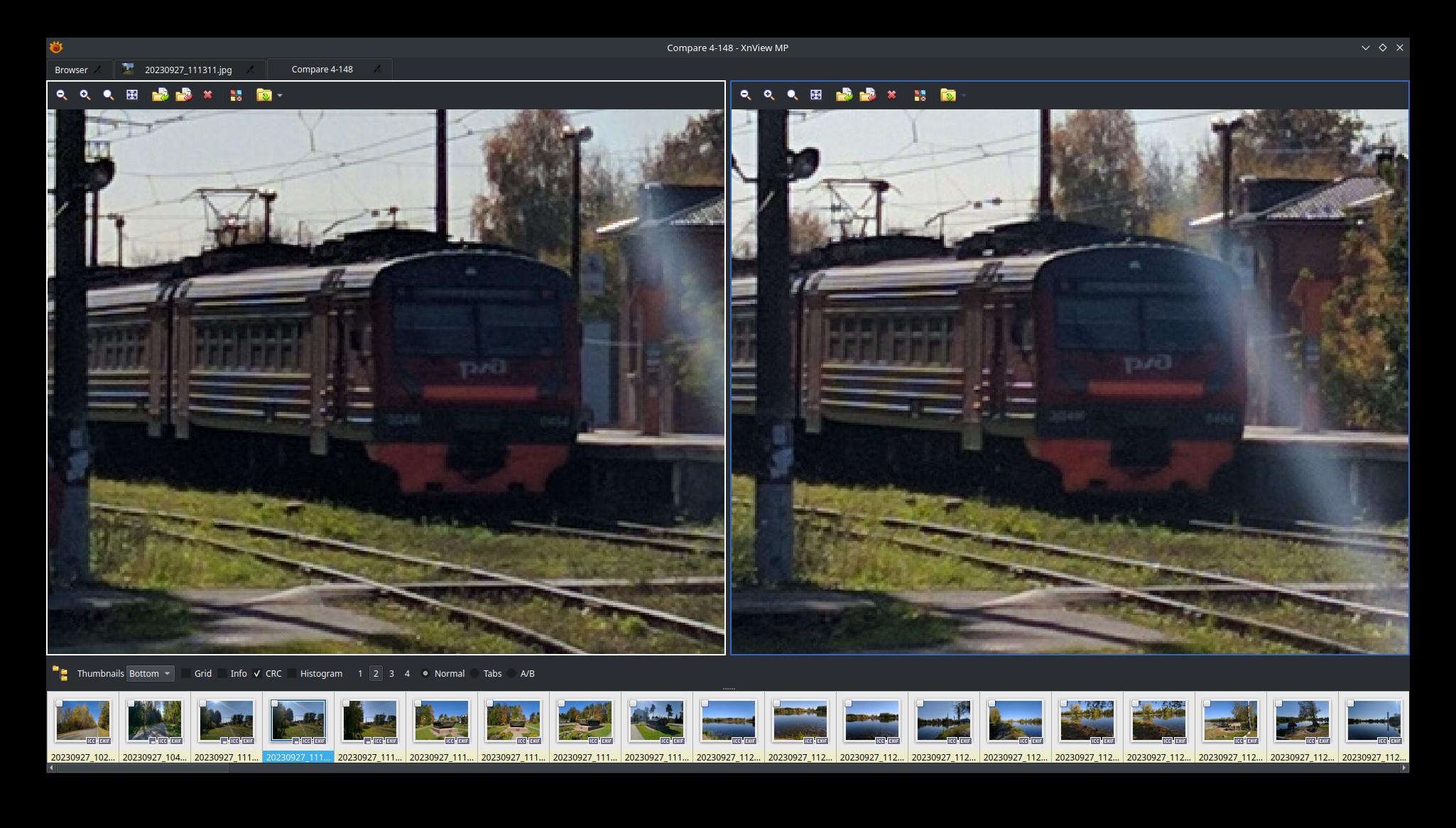

So, I installed 1.5.5. 64 bit (Linux) 8-sep-2023. The problem doesn't seem to be fixed. How to reproduce:
1) take 2 similar images with some shift in view (attached test1 and test2).
2) compare them
3) zoom both images to some extent to see the train (for example)

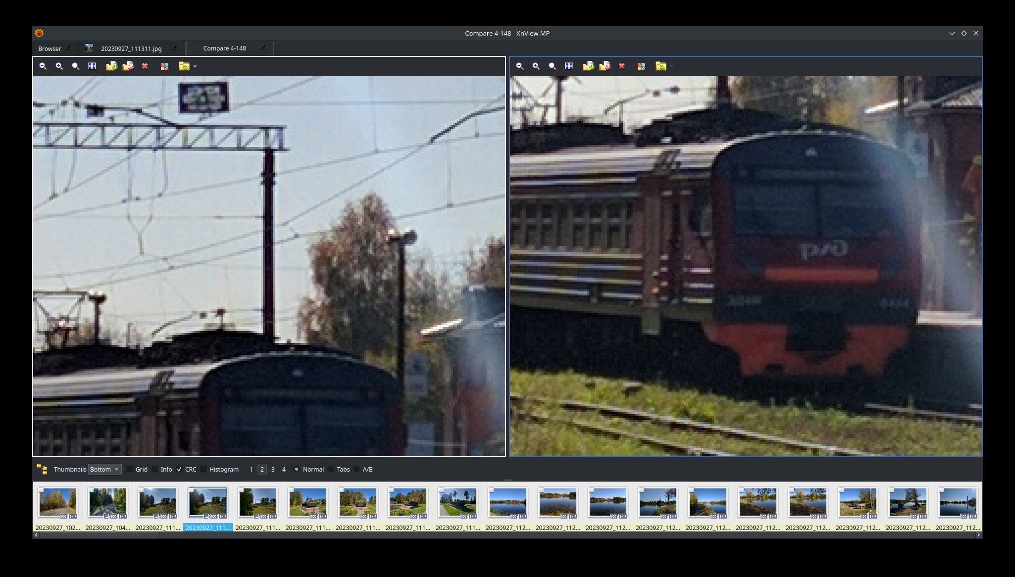

4) move one image so that a selected object would be in the same place as in the other photo: 5) zoom in or out. the alignment fails, you need to reposition the image with every zoom in and out: Test images:
2) compare them
- Posts: 47859
Re: Compare images - zoom at fixed place (do not reset images position when zooming)
you need to use CTRL to change behavior
tol
- Posts: 10
- Joined: Fri Nov 18, 2022 9:49 am
CTRL is for zooming one image only. But SHIFT-MOUSE WHEEL seems to work as it should. It is not obvious and not convenient. Maybe change behavior so that WHEEL should work the way the SHIFT-WHEEL works now? Not sure that anyone is happy by resetting the alignment position as it happens by default without pressing shift when zooming. I think if you want to keep the unaligned zoom, let it be SHIFT-WHEEL and aligned zoom only WHEEL. IMHO
- Posts: 47859
Sorry SHIFT. I can't change the behavior, many users had complaint about this...tol wrote: Sun Oct 15, 2023 8:34 am CTRL is for zooming one image only. But SHIFT-MOUSE WHEEL seems to work as it should. It is not obvious and not convenient. Maybe change behavior so that WHEEL should work the way the SHIFT-WHEEL works now? Not sure that anyone is happy by resetting the alignment position as it happens by default without pressing shift when zooming. I think if you want to keep the unaligned zoom, let it be SHIFT-WHEEL and aligned zoom only WHEEL. IMHO![]()
