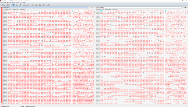

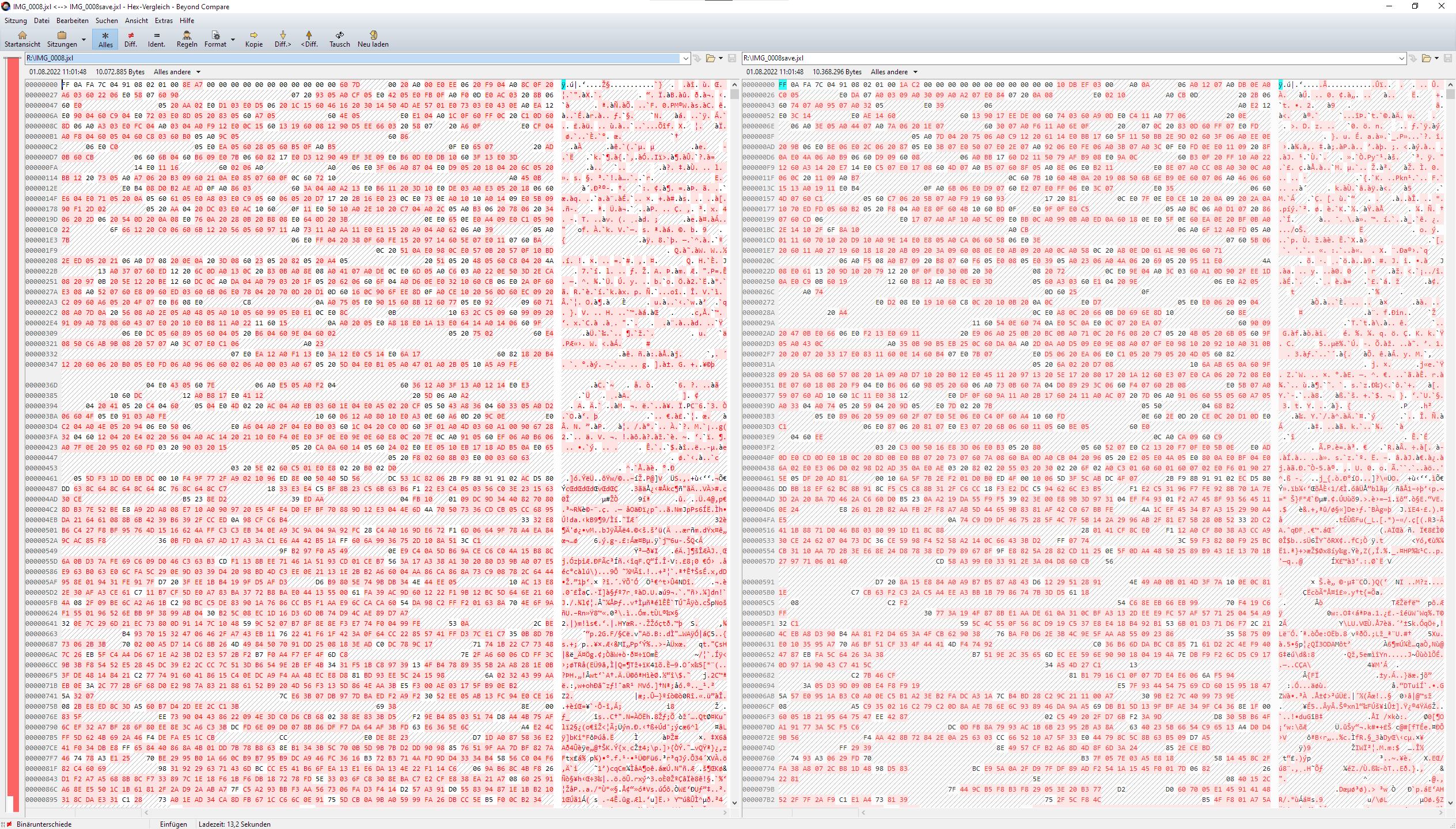

Nope, its 7 and quality 85 on booth photos.masterjp wrote: Wed Dec 14, 2022 6:57 pm You used different compression settings! In most cases the compression effort (=efficiency) is the problem.
I tried lossless compression 7 and the colors are as expected on booth photos. They have also a different filesize.
The hex comparison shows two completely different files, lossless files should be identical with the same settings.

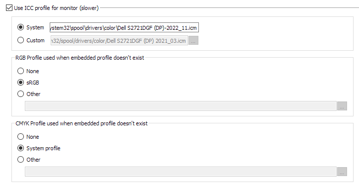

Re: JPEG-XL save dialog wrong color
Looks like the sRGB option alters the saved file but only when is use the save dialog.
Interesting. I don't use icm profiles, because I thought Windows use them for all programs.
Is your display calibrated with a software or is it a file from your display driver?
I used an older Spyder calibration device to calibrate my display.
Maybe it is better to use the icm profile with in windows and not in XnviewMP.
- Posts: 48933
When using ICC profile, you change the data of picture (edit mode)
