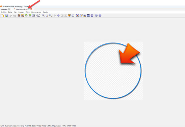

The image when viewed individually looks fine:

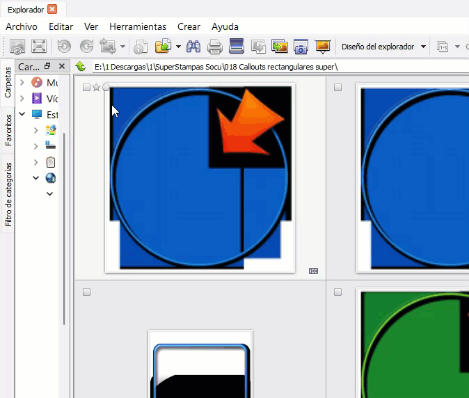

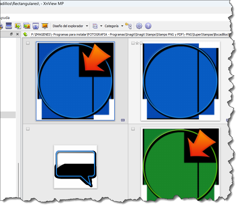

But when displayed in the browser, the image is not seen:
Are there any settings that can be made to be able to see the files properly from the file explore

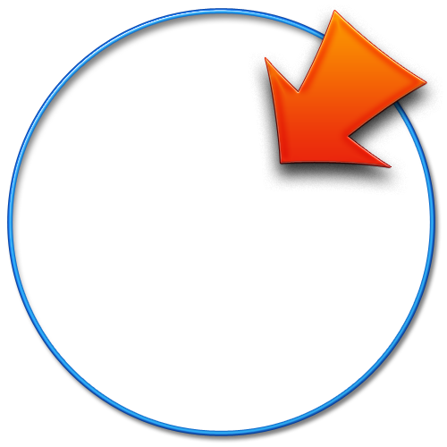

Hi, you got it, and sorry, I meant to post it, but I forgot.
Blue neon circle arrow.png (76.61 KiB) Viewed 1421 times

it's good here, do you have selected your file, and 'View>Rebuild thumbnails'?
