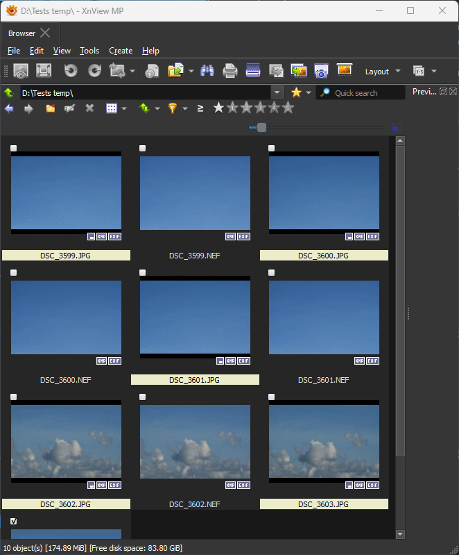

- Select "associated" files (same name, just different extension) (tested with a NEF and a Jpeg)
- Batch rename ("Tools > batch rename" or "Edit > rename")
- try to rename the files (eg. replacing part of the filename string)
=> an error message and no renaming

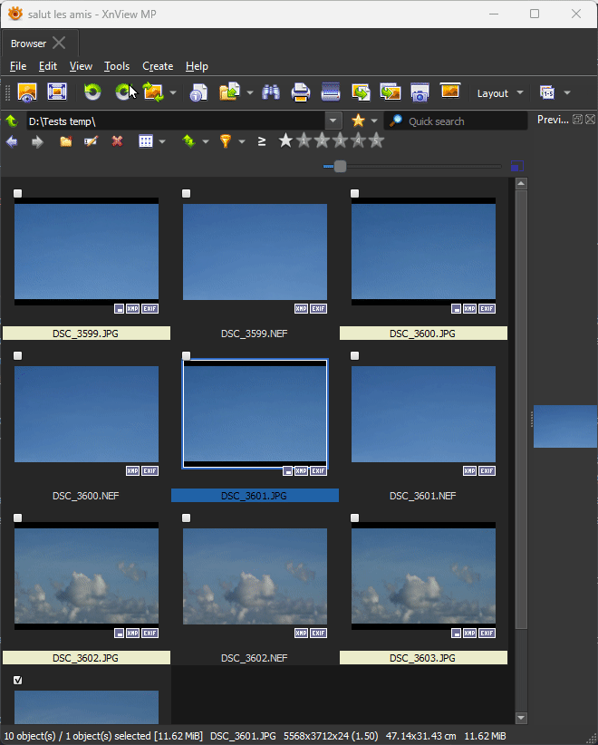

Post by Gwenael Q. »
Exactly same issue with batch rename :

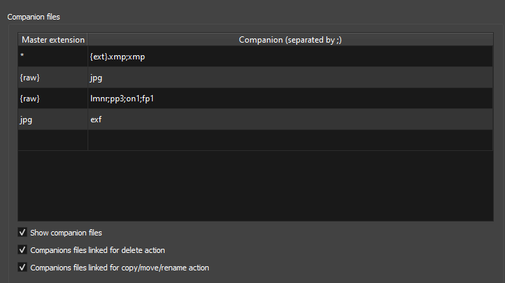

Probably far from being optimized as I don't recall having found a complete explanation for these settings.
Thanks for listening

In the GIFs above you can see that I select both .jpeg and .nef
Posts: 48862
Re: Batch rename error with associated files
if you select jpg&nef, you have a warning dialog because companions are automatically renamed

My companion file settings:

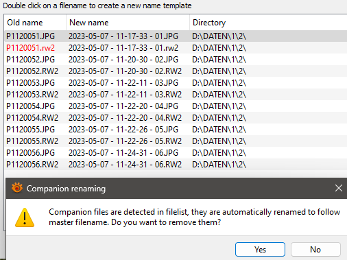

When I select a range of jpg files along with their RW2 companions and try to batch rename them, I get the newly introduced alert:
It seems random which of the companion files are recognized as such and get removed when I hit yes.
Anyway, the result is always "The files cannot be renamed, an error occurred."
This means: No matter if I hit Yes or No and (in case of Yes) no matter if the recognized companion files are removed from the list. Only in the case that all companion files have been correctly recognized the renaming is successful.
In most cases only a few of the companions are detected, sometimes none at all.
So I believe there are different problems:
  1. The alert message is not clear. At least to me. After reading this thread I understand "they are automatically renamed" means "... anyway, so they are superfluous".
  2. The error message after failure is completely unclear. The list in the rename dialogue looks like everything should work fine, just the way it is expected (anyway).
  3. If there is a "yes/no" option I would expect that leaving the companions in the list would render a result, too. And a result that is different from removing them from the list. So I would expect this to be a.jpg, a.rw2, b.jpg, b.rw2 -> 1.jpg 2.rw2, 3.jpg, 4.rw2.
Best regards
