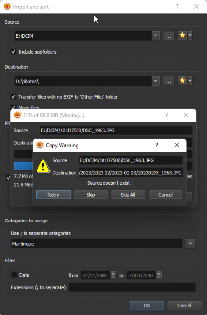

After having used this feature without problems for some time, I get an error every time I use it now (regression with a recent update ?) when move option is activated....
Source doesn't exist ??? Obviously, source file exists and was found by the software some instant before.
I use to import jpg+RAW. This issue won't happen if I import jpeg without raw associated on the memory card.... I strongly suspect this issue to be related to companion files handling.

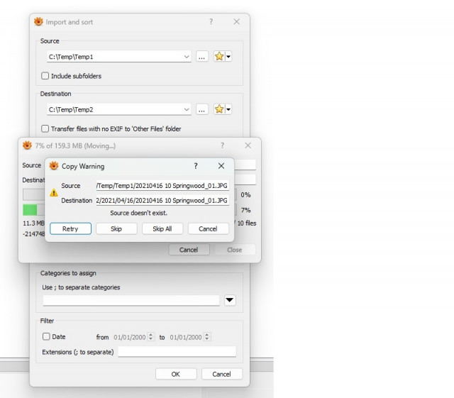

Hi Pierre
Yes, that's the problem. I routinely import .jpg and .nef files from my Nikon camera. With versions 1.4.1 and 1.4.2, I get the following error
If I just import .jpg or .nef files on their own, it works OK. Also, if I downgrade to version 1.4.0, it works OK, so there must be some change between 1.4.0 and 1.4.1 that has introduced the problem.
Hope this helps.
Steve
