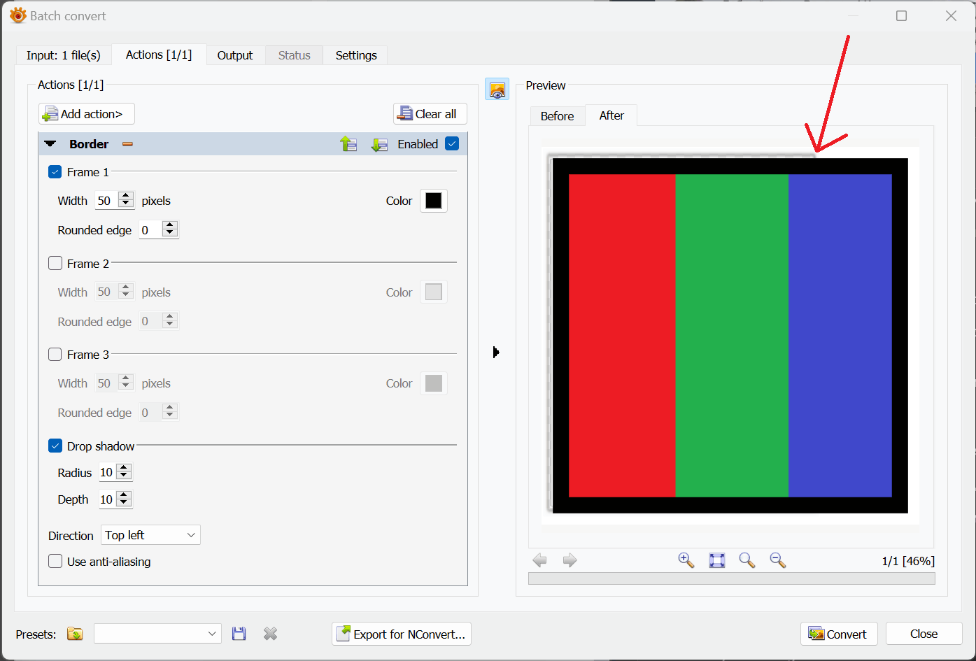

XnViewMP 1.4.2 64bits
Windows11 64bit (22H2), display resolution 3840x2160, win scaling 150%
Batch convert
Border's Shadow effect has incorrect size on test file
test_image.zip
(939 Bytes) Downloaded 176 times

Confirmed.

It appears that certain types of PNG mess up this effect?
Here's what resulted on my tests:
Works
Using random PNGs, WEBPs, and JPEGs in my personal library
Broken
Using your sample PNG image
Broken
Resaving your sample PNG image as a new PNG image
Works
Saving your sample PNG image as a WEBP or JPEG image
Works
Using the converted WEBP/JPEG image and converting it back into a PNG image
It's really weird. I couldn't figure out if there's any metadata or property of the original PNG that breaks this effect?

@user0, I think I figured it out.
After some further testing, I narrowed it down to 32-bit PNGs
The effect works fine with 24-bit PNGs.
The bug occurs if it is a 32-bit PNG.
Perhaps this effect has an issue with the extra 8-bit "transparency" (alpha) channel.

fixed in 1.4.3
