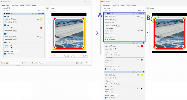

Suggestion A
  • remove extra Frames
    as it is already possible to achieve the same effect provided by 3 Frames but with 3 consequent Border actions.
    In theory multiple Frames in single action may be helpful:
    • if there is Presets functionality available where you can define multiple borders, but this is not a case here. One also can create global Batch convert's preset or export for NConvert.
    • Frame effects interact with each other in a special way, not avaialble when you apply them consequently. Not a case as well.
    • why exactly 3 frames, why not 4 or 5. Anyway, I doubt this feature is popular nowadays.
  • add Frame type selector (outer/inner) and Opacity for inner frame
    type selector can be in the form of checkbox for now, but imho dropbox/radio button would be more explicit
  • add Background color
    required for background under Round edges and Shadow
  • add Shadow color

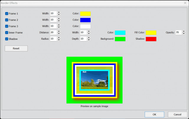

Suggestion B
  • make Shadow follow the Round border
Mockup
The layout of the controls is just one under the other, as I somehow don't see the complex structure in batch mode.

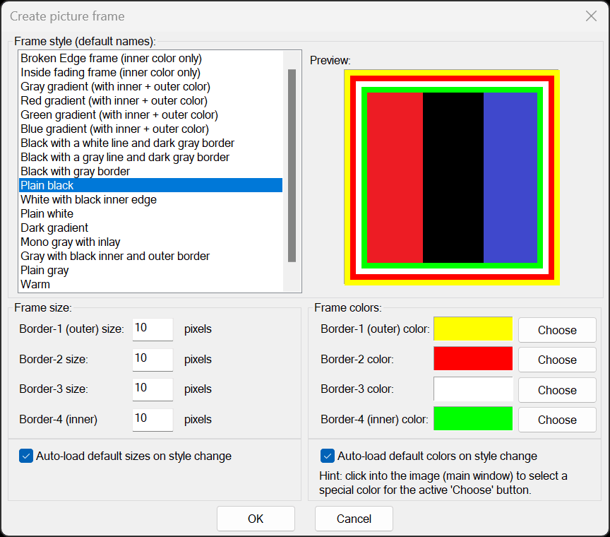

Examples from other apps
  • FastStone

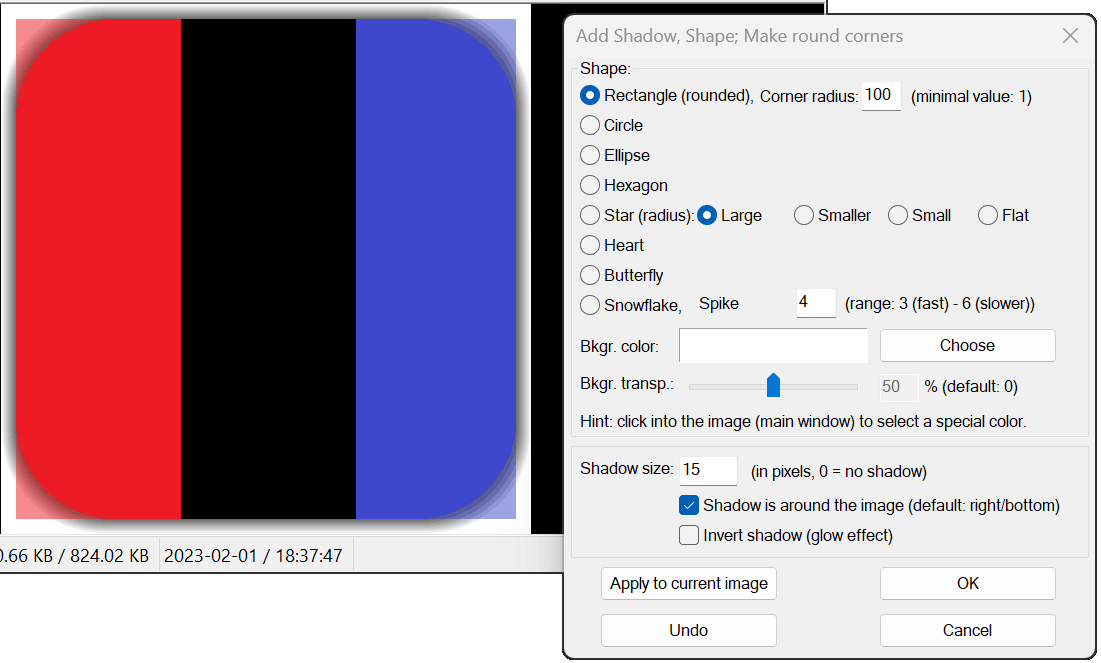

  • IrfanView
    • Add border/frame
    • Add Shadow, Shape, Rounded corners...

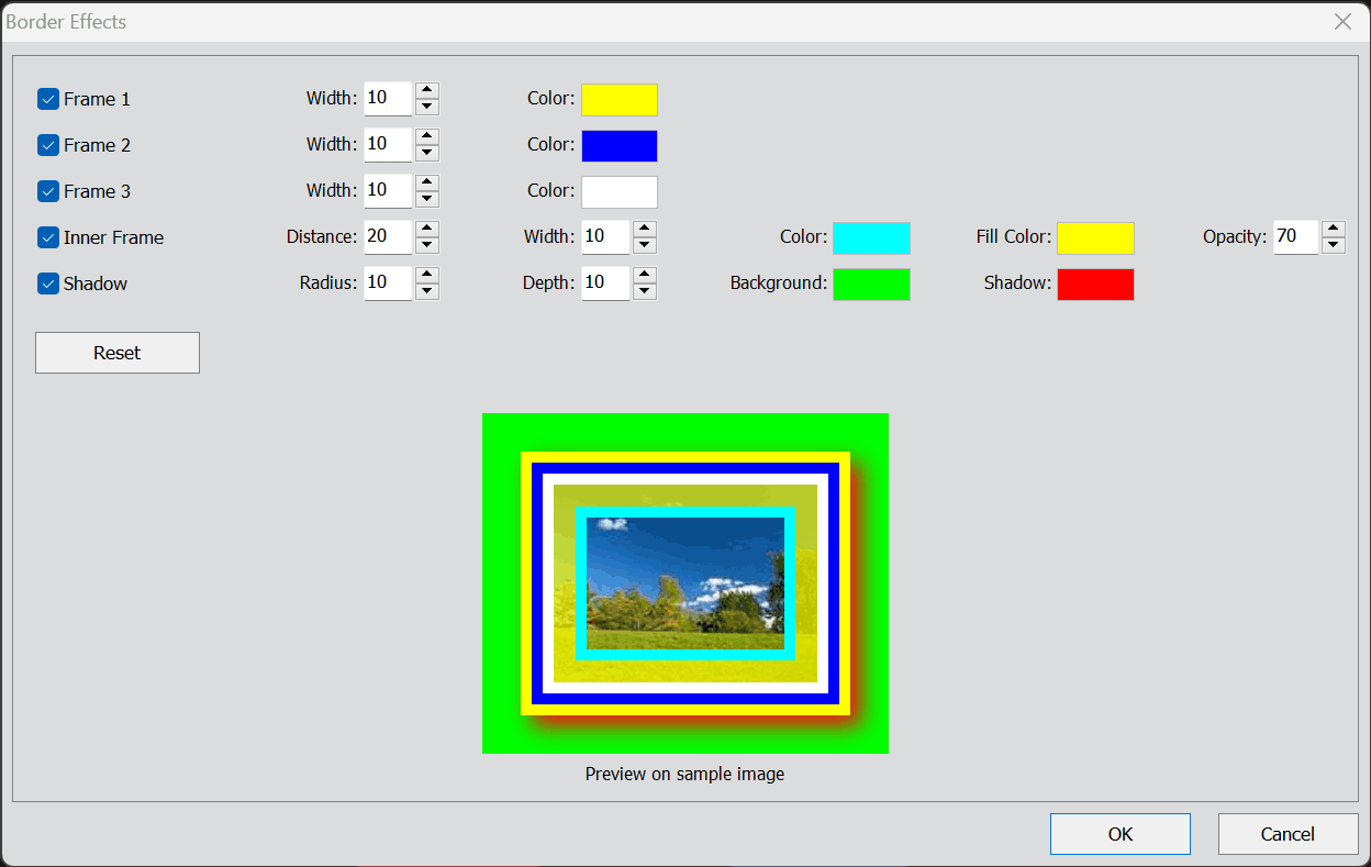

I keep the 3 borders in 'Border' action, better to customize, and fix the issue with shadow.
And i add 'inner frame' action

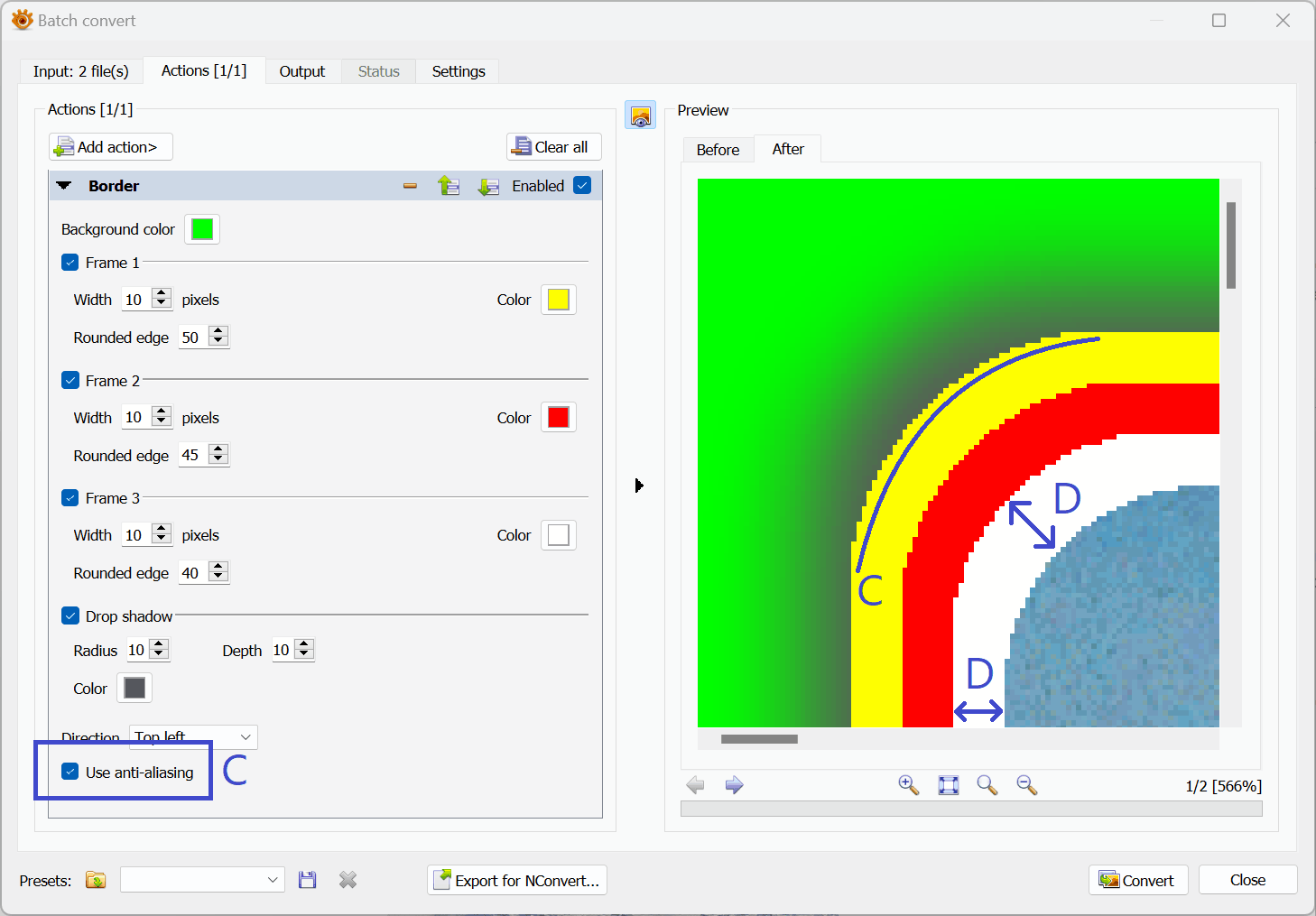

few issues though:
C. it looks like 'Use anti-aliasing' checkbox has no effect
D. it would be nice to have more even thickness of border on sides and in corners.

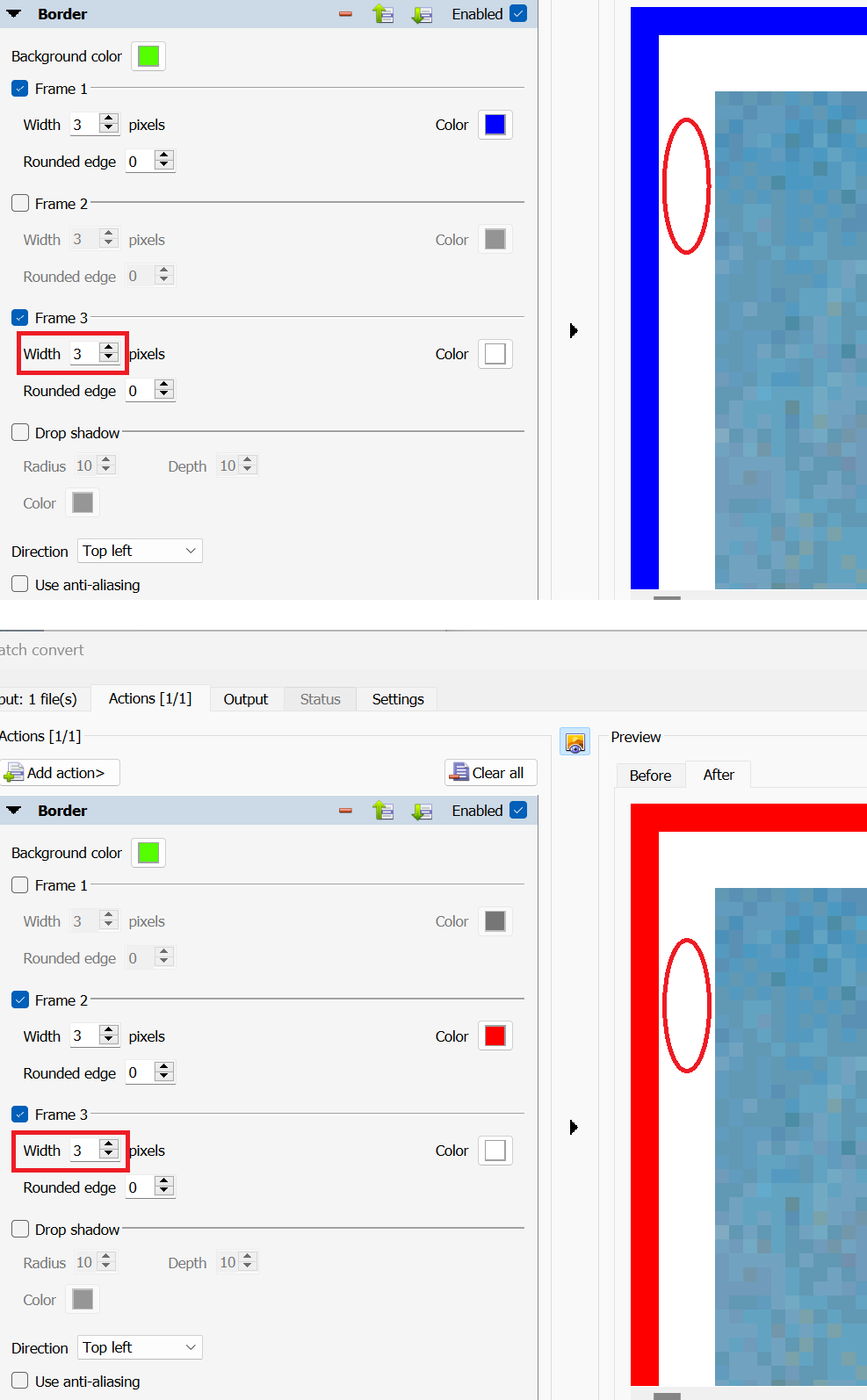

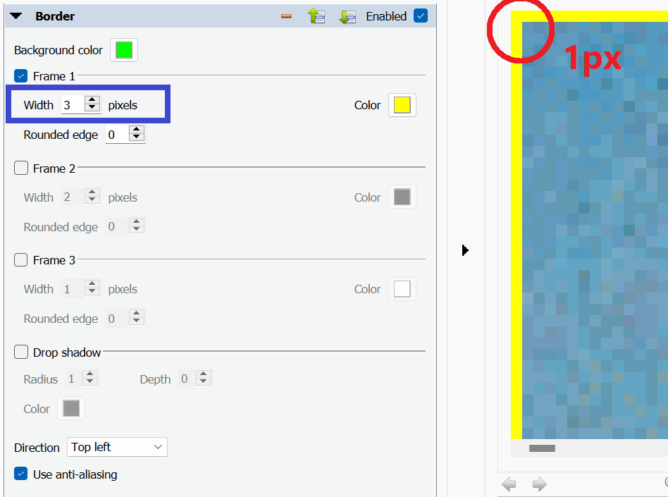

E. there is some mess with settings width:
- if have 1 frame - 1st pixel in preview starts on 3rd pixel in settings (see picture)
- if have 2 frames - 1st frame magically fixes, but 2nd frame's 1st pixel in preview starts from 2nd pixel in settings
- try ticking/unticking Frames checkboxes in different order and start with 0px thickness

user0 wrote: Tue Apr 18, 2023 4:57 pm C. it looks like 'Use anti-aliasing' checkbox has no effect
Posts: 47002
Re: Batch convert - improve Border effect
This problem is supposed to be fixed in XnView MP 1.4.5. Please check and confirm the bug fix here.
Posts: 2646
1.4.5
C - fixed
D - still remain
E - still remain

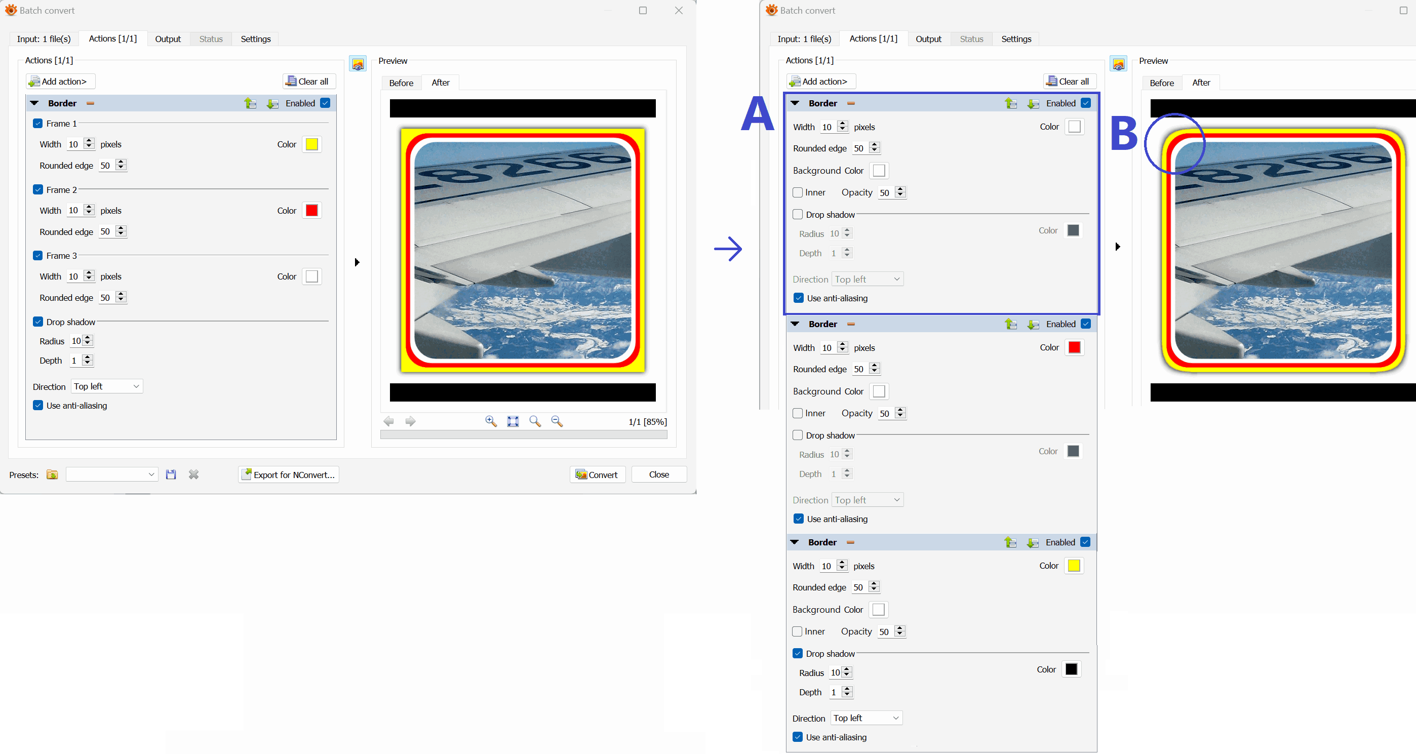

1.5.0b1
all fixed, except D
is it possible to make border of uniform thickness, like red line ?)
Posts: 47002
user0 wrote: Sat Jun 17, 2023 6:14 pm is it possible to make border of uniform thickness, like red line ?)
i've tried but i can't....
