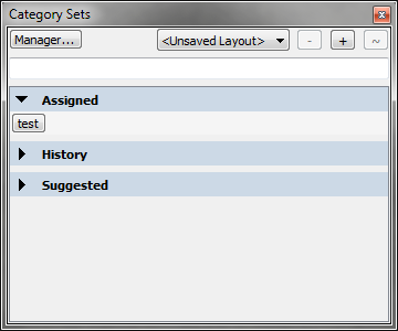

You can look at the "Category Sets" panel ( with View > Panels > Category sets enabled )

- Posts: 1588
Re: How to see only the categories assigned to an image
In "Category Sets" pane, only assigned categories are shown ...WhiteTiger wrote: Fri May 05, 2023 5:40 pmThis does not solve the problem because there are dozens of unassigned categories and the assigned ones are "lost" in this large number.michel038 wrote: Fri May 05, 2023 10:39 am You can look at the "Category Sets" panel ( with View > Panels > Category sets enabled )
It was in this panel that I was hoping to see only the assigned ones.
You can move this pane, even out of XnViewMP window
