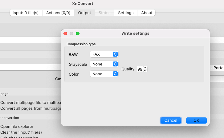

Thanks a lot! I don't have a File menu but I suppose I can use this (see attached screenshot).
What should I use for grayscale and color?
Posts: 4537
Re: Converted PDF files 10 times the original TIF
That's it... :D
Posts: 4537
Re: Converted PDF files 10 times the original TIFF [Solved]
Jerry_D wrote: Thu Jun 01, 2023 11:14 am What should I use for grayscale and color?
When filesize is a consideration JPEG compression is usually the only option, but depending on the particular images and the final image quality required, filesize may sometimes be significantly reduced by experimenting with lower quality settings. It is in any case rarely necessary to use a quality setting greater than, say, 80 or 85.
An exception is for colour images with a small number of colours, such as those that might be produced by a drawing software, in which case another compression option such as PNG may result in a much smaller filesize.
