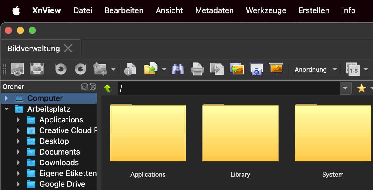

I have been using XnView for over 12 months on my Macbook M2, so far in German.
After the update in December everything is in English, how do I set a different language?
Currently 1.6.4 with Macos Sonoma 14.2.1
Either I'm too stupid to find it in the settings or something else has changed that I can't figure out myself.
Can anyone help?

This is how I actually understood it, that XnView takes over the native language for Maxos.
This may be why there is no setting option.

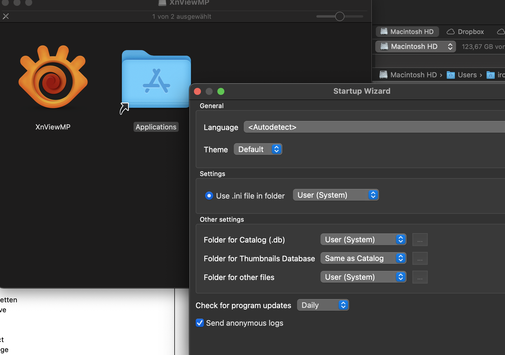

I have just created a new user. Here, the language, color scheme, etc. are queried at the first "Start-Up" start.
German works here.
So I should know how to delete old settings. Uninstalling and reinstalling did not start the Startup Assistant.
Update:
I deleted all files that somehow contained "..xnview.:", so that the start-up configuration wizard started again. I then manually selected German, so that works for me. The "autodetect" function may have had a problem with the language.
German works here.
Update:

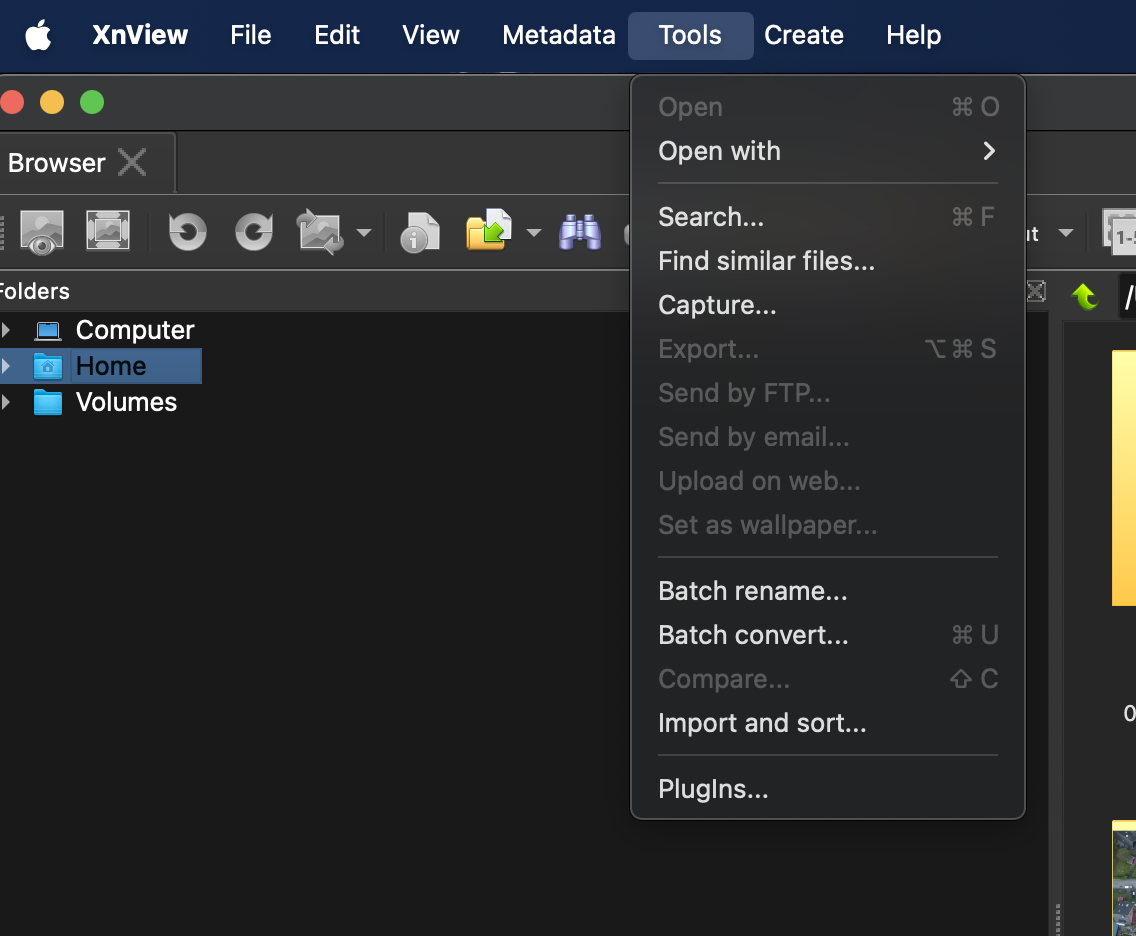

- Posts: 49003
Re: Change the language
Settings on Mac is moved in XnView menu
TimXN
- Posts: 5
- Joined: Sun Jan 14, 2024 1:34 pm
Could you please explain what is meant by "menu"? As I wrote before, I did not find the settings in any menu pulldown and only the first clean installation brought back the question and the language setting
- Posts: 49003
in 'XnView', you have preferences
