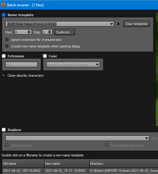

Before I edit or comment/categorise the photos, I immediately rename them with the tool "batch rename". For this I use the name template {EXIF:Date Taken [Y-m-d_HMS]}. At this point there are neither sidecar files nor associated files.
Now here is the problem:
Since a short time I get the error message: "The files cannot be renamed, an error occurred" when I try to "batch rename" my RW2 files.
The error does not occur with the "batch rename" of jpg files.
The error does not occur with the "Rename (F2)" function.
I suspect the error is not in the file area or the general function of renaming files, but in the module "batch rename" or in the handling of RW2 files by XnviewMP.
Can you help me with this?

here my settings.
I have been using them for some time, even before the error occurred.

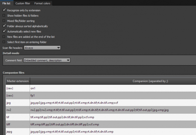

Re: Error by batch rename of RW2-files
Hello Pierre,
I have simply inserted the ini file completely as text.
I have deleted some lines with private data. However, this should have no influence on the troubleshooting.
Regards, Otrag

showCompanionFiles=true

[Companion]
useForDelete=true
useForOther=true
list="@Variant(\0\0\0\v\0\0\0\x2\0\0\0\n\0{\0r\0\x61\0w\0}\0\0\0\"\0{\0\x65\0x\0t\0}\0.\0x\0m\0p\0;\0x\0m\0p\0;\0j\0p\0g)", @Variant(\0\0\0\v\0\0\0\x2\0\0\0\n\0{\0r\0\x61\0w\0}\0\0\0\b\0l\0m\0n\0r), @Variant(\0\0\0\v\0\0\0\x2\0\0\0\n\0{\0r\0\x61\0w\0}\0\0\0\x6\0p\0p\0\x33), @Variant(\0\0\0\v\0\0\0\x2\0\0\0\n\0{\0r\0\x61\0w\0}\0\0\0\x6\0o\0n\0\x31), @Variant(\0\0\0\v\0\0\0\x2\0\0\0\n\0{\0r\0\x61\0w\0}\0\0\0\x6\0\x66\0p\0\x31), "@Variant(\0\0\0\v\0\0\0\x2\0\0\0\x6\0j\0p\0g\0\0\0\x98\0j\0p\0g\0.\0p\0p\0\x33\0;\0j\0p\0g\0.\0x\0m\0p\0;\0r\0t\0.\0t\0i\0\x66\0;\0r\0t\0.\0t\0i\0\x66\0.\0o\0u\0t\0.\0p\0p\0\x33\0;\0r\0t\0.\0t\0i\0\x66\0.\0x\0m\0p\0;\0r\0t\0.\0\x64\0n\0.\0t\0i\0\x66\0;\0r\0t\0.\0\x64\0n\0.\0t\0i\0\x66\0.\0x\0m\0p\0;\0x\0\x63\0\x66)", "@Variant(\0\0\0\v\0\0\0\x2\0\0\0\x6\0r\0w\0\x32\0\0\0\xec\0r\0w\0\x32\0.\0p\0p\0\x33\0;\0r\0w\0\x32\0.\0x\0m\0p\0;\0r\0t\0.\0t\0i\0\x66\0;\0r\0t\0.\0t\0i\0\x66\0.\0o\0u\0t\0.\0p\0p\0\x33\0;\0r\0t\0.\0t\0i\0\x66\0.\0x\0m\0p\0;\0r\0t\0.\0\x64\0n\0.\0t\0i\0\x66\0;\0r\0t\0.\0\x64\0n\0.\0t\0i\0\x66\0.\0x\0m\0p\0;\0r\0t\0.\0\x64\0n\0.\0t\0i\0\x66\0.\0o\0u\0t\0.\0p\0p\0\x33\0;\0t\0i\0\x66\0;\0t\0i\0\x66\0.\0o\0u\0t\0.\0p\0p\0\x33\0;\0j\0p\0g\0.\0x\0m\0p\0;\0j\0p\0g)", "@Variant(\0\0\0\v\0\0\0\x2\0\0\0\x6\0t\0i\0\x66\0\0\0j\0t\0i\0\x66\0.\0x\0m\0p\0;\0t\0i\0\x66\0.\0p\0p\0\x33\0;\0t\0i\0\x66\0.\0o\0u\0t\0.\0p\0p\0\x33\0;\0\x64\0n\0.\0t\0i\0\x66\0;\0\x64\0n\0.\0t\0i\0\x66\0.\0p\0p\0\x33\0;\0x\0\x63\0\x66\0.\0x\0m\0p)", "@Variant(\0\0\0\v\0\0\0\x2\0\0\0\b\0t\0i\0\x66\0\x66\0\0\0t\0t\0i\0\x66\0\x66\0.\0x\0m\0p\0;\0t\0i\0\x66\0\x66\0.\0p\0p\0\x33\0;\0t\0i\0\x66\0\x66\0.\0o\0u\0t\0.\0p\0p\0\x33\0;\0\x64\0n\0.\0t\0i\0\x66\0\x66\0;\0\x64\0n\0.\0t\0i\0\x66\0\x66\0.\0p\0p\0\x33\0;\0x\0\x63\0\x66\0.\0x\0m\0p)", "@Variant(\0\0\0\v\0\0\0\x2\0\0\0\b\0j\0\x65\0p\0g\0\0\0\x90\0j\0p\0g\0.\0p\0p\0\x33\0;\0j\0p\0g\0.\0x\0m\0p\0;\0r\0t\0.\0t\0i\0\x66\0;\0r\0t\0.\0t\0i\0\x66\0.\0o\0u\0t\0.\0p\0p\0\x33\0;\0r\0t\0.\0t\0i\0\x66\0.\0x\0m\0p\0;\0r\0t\0.\0\x64\0n\0.\0t\0i\0\x66\0;\0r\0t\0.\0\x64\0n\0.\0t\0i\0\x66\0.\0x\0m\0p)", @Variant(\0\0\0\v\0\0\0\x2\0\0\0\x6\0m\0p\0\x34\0\0\0\xe\0m\0p\0\x34\0.\0x\0m\0p), "@Variant(\0\0\0\v\0\0\0\x2\0\0\0\x6\0p\0n\0g\0\0\0&\0p\0n\0g\0.\0p\0p\0\x33\0;\0p\0n\0g\0.\0o\0u\0t\0.\0p\0p\0\x33)", "@Variant(\0\0\0\v\0\0\0\x2\0\0\0\x6\0\x64\0n\0g\0\0\0\xfc\0\x64\0n\0g\0.\0p\0p\0\x33\0;\0\x64\0n\0g\0.\0x\0m\0p\0;\0r\0t\0.\0t\0i\0\x66\0;\0r\0t\0.\0t\0i\0\x66\0.\0o\0u\0t\0.\0p\0p\0\x33\0;\0r\0t\0.\0t\0i\0\x66\0.\0x\0m\0p\0;\0r\0t\0.\0\x64\0n\0.\0t\0i\0\x66\0;\0r\0t\0.\0\x64\0n\0.\0t\0i\0\x66\0.\0x\0m\0p\0;\0r\0t\0.\0\x64\0n\0.\0t\0i\0\x66\0.\0o\0u\0t\0.\0p\0p\0\x33\0;\0t\0i\0\x66\0;\0t\0i\0\x66\0.\0o\0u\0t\0.\0p\0p\0\x33\0;\0j\0p\0g\0;\0j\0p\0g\0.\0p\0p\0\x33\0;\0j\0p\0g\0.\0x\0m\0p)", @Variant(\0\0\0\v\0\0\0\x2\0\0\0\x6\0x\0\x63\0\x66\0\0\0\xe\0x\0\x63\0\x66\0.\0x\0m\0p)

[Companion]
useForDelete=true
useForOther=true

It works here, are you able to reproduce with 2 files?

Hi Pierre,
yes, i can, but how do i show the result?

Hi Pierre,
I noticed the following:
Normally I only take photos in Panasonic RW2 RAW format.
But now I have created RW2 and JPG photos in parallel.
For JGP I have added RW2 to the Companion List.
With the BATCH RENAME I get the following result:
1st approach: Rename RW2 photos with BATCH RENAME as described by me in the beginning = error as described = RW2 and the companion JPG photos are not renamed.
2nd approach: Rename JPG photos with BATCH RENAME = JPG and the companion RW2 photos are renamed.
Does this possibly limit the troubleshooting?
ok, i can reproduce now...OTRAG wrote: Sat Jul 01, 2023 9:07 am 1st approach: Rename RW2 photos with BATCH RENAME as described by me in the beginning = error as described = RW2 and the companion JPG photos are not renamed.
yes normal2nd approach: Rename JPG photos with BATCH RENAME = JPG and the companion RW2 photos are renamed.
