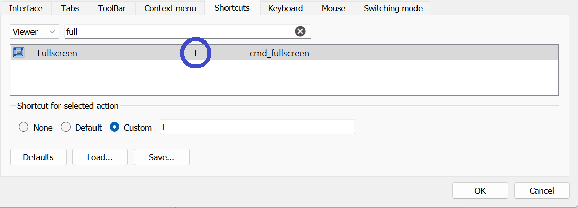

- Posts: 3113
Re: 1.5 64 bit (earlier 1.4.5 64 bit) - Can't change shortcut
it works
however, entering new shortcut is a bit unpleasant as
there is 2 sec delay before your newly typed shortcut will be accepted (see blue circle)
only after that you can press OK

- Posts: 48658
yes there is a little delay to be able to enter multiple keyuser0 wrote: Tue Jul 18, 2023 5:55 am however, entering new shortcut is a bit unpleasant as

- Posts: 3113
shortcuts for Browser and Viewer modes are different
you have to select right mode before changing shortcut (see combobox in the top left corner on picture in prev post)
