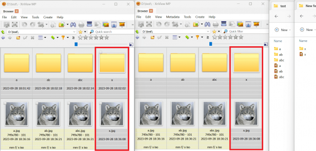

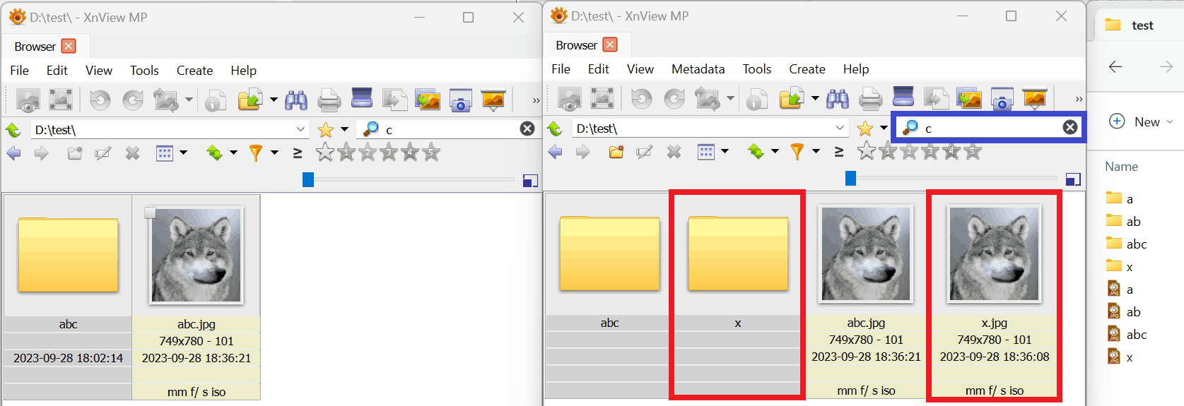

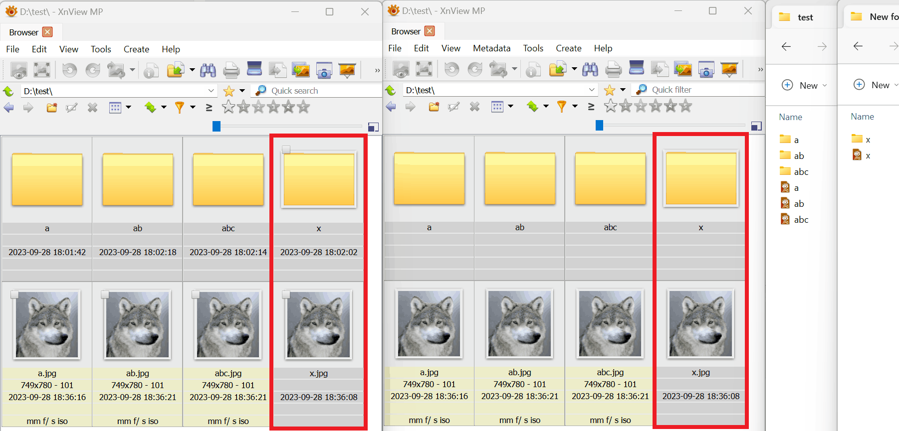

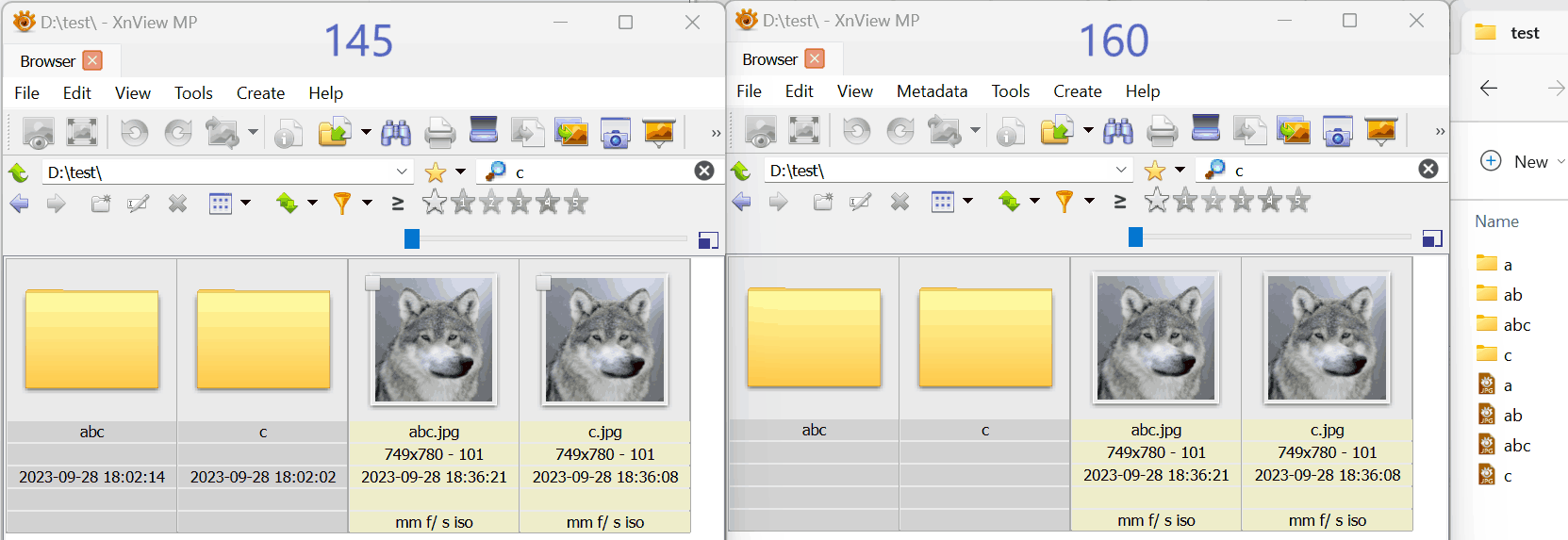

0. start with the following structure/settings
- 2 clean portable versions (145, 160b) run from different folders
issue A
1. rename file/folder c to x in 160 (or145)
x will dissapear from filelist in other instance - OK
current instance still have x
2. press F5
nothing happens current instance still have x
issue B
1. (in win file explorer) rename file/folder c to x
x will dissapear from filelist - OK
2. (in win file explorer) move x file/folder from current folder (test) to some other folder
3. remove filter
there will be ghost x file/folder
4. press F5
ghost file/folder will dissapear
issue A
2. press F5
issue B
3. remove filter
4. press F5
