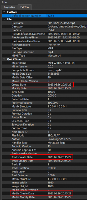

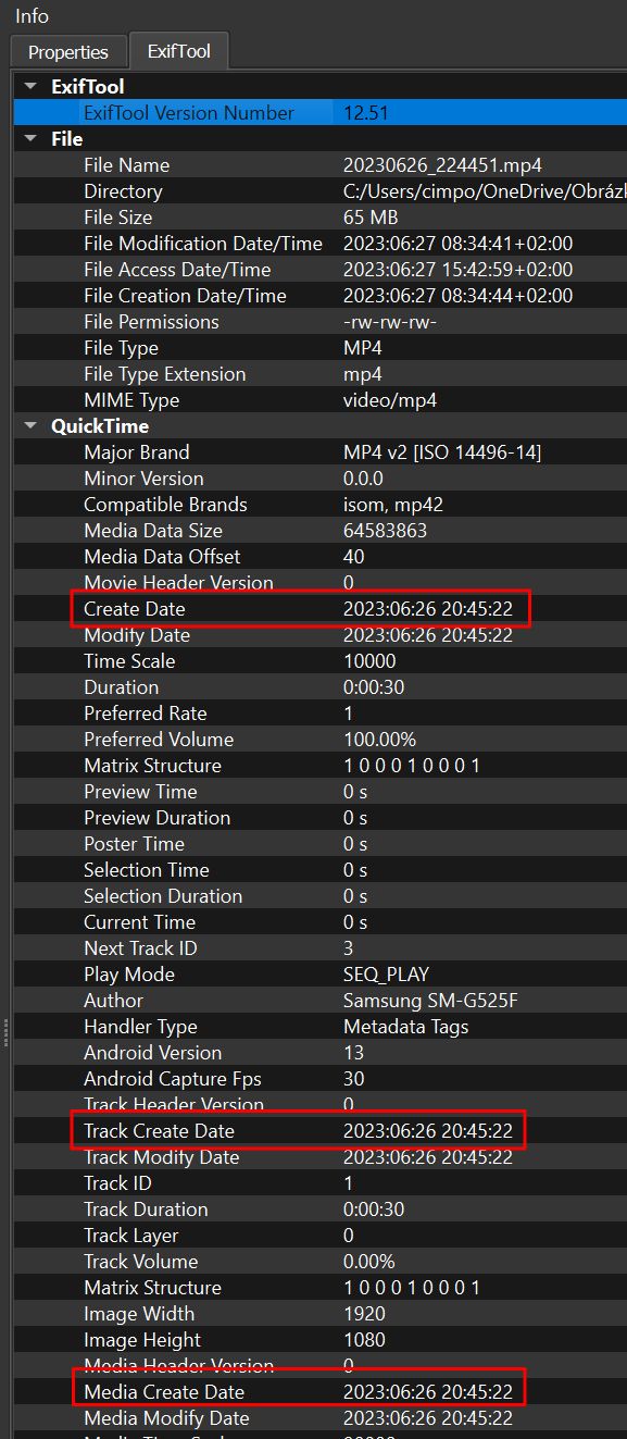

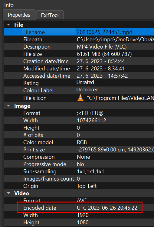

If not, can you implement a simple fallback mechanism for video creation date? The info is there and XnView MP can read it. The mp4 files from my cheap Samsung phone contain it on several places:
and
So instead of assuming an empty "EXIF Date taken" for video files, you can check the metadata above until the first one is found and use this value. (Note, it's in UTC, so the current time offset needs to be added). This way, we could perform various operations with the video files that require the date taken, such as: sorting, batch rename, thumbnail labels and tooltips, etc.

which would first search (in videos) "Encoded date". If not found, then "Quicktime: Create Date" and possibly others. And only if none of these were found, the file's modified date would be used as the last resort.
