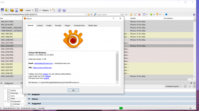

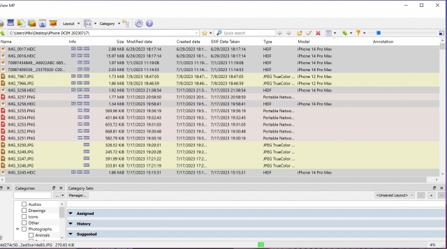

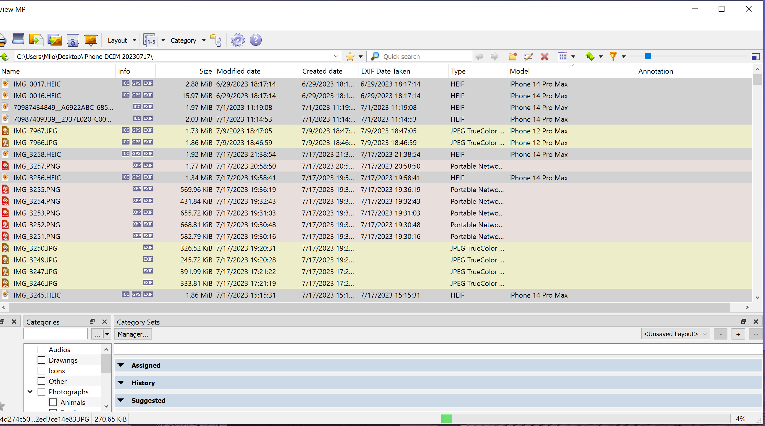

I am using sorting by Model quite frequently and I can instantly tell when the sorting goes wrong.

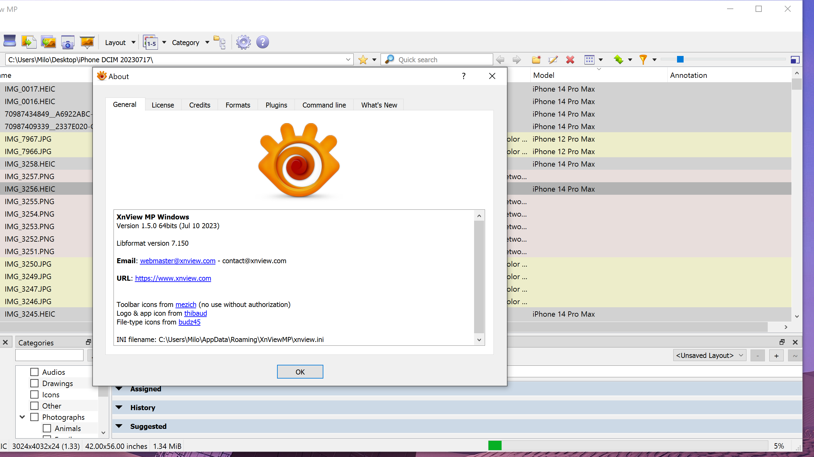

On XnView MP 1.4.5 and 1.5.0, the sorting is even slow on SSD and significantly using up CPU resources. Most of the time the sorting will stop on its own and the the list will not be sorted, leaving a column like this:
And after a long while, the bar is only running at 5%:

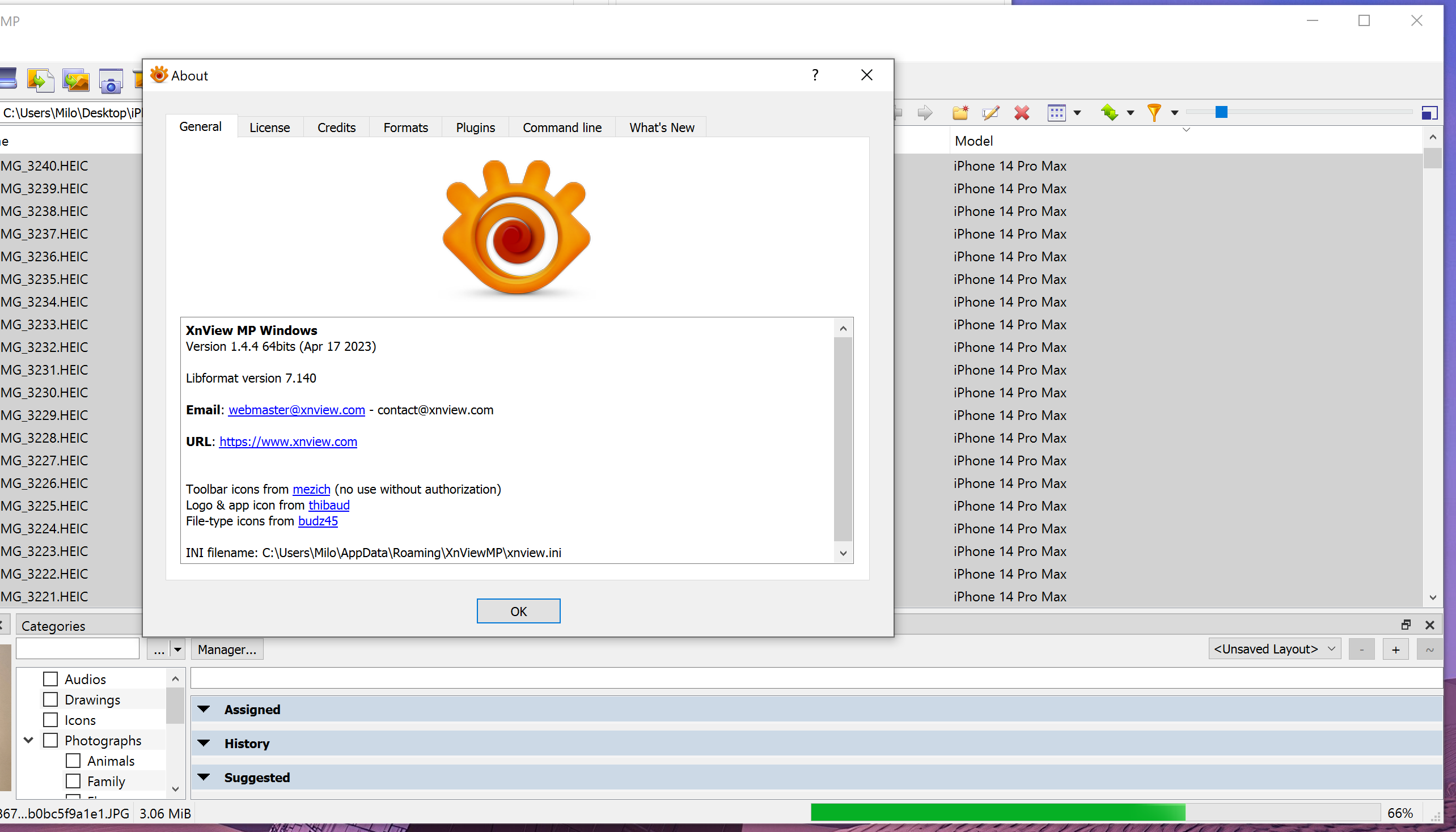

The issue is not observed on 1.4.4 and lower versions, and 1.4.4 can finish sorting by Model (with large HEIC files (20MB~1.7MB, 2600 or so files of this kind) within a minute or so.

Scan file headers are set to always, I turned off Scan header and Catalog and updated to 1.5.0 just now to see if it's fixed but... If the scan headers are set to never, the viewer will not even load or show Info/Model/EXIF Date Taken... Thus the sorting with Model/EXIF Date Taken will never complete.
I have attached a couple of videos, respectively, to show you how slow this is on 1.5.0 comparing to 1.4.4: (With Catalog on, Scan Header set to Always, the only difference I can think of is the installed version.)
