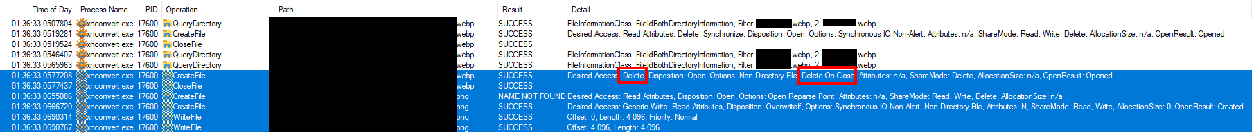

2. Turning on "Delete original" removes original file before converted one is written to disk.
This was a shock to me. I was using Process Monitor to analyze that 1st point and then I saw this This was a test to convert web to png. First the whole source file is read to memory (not shown here), then it clearly shows that webp file is accessed (CreateFile operation) with intent to remove it (Desired Access: Delete, Delete On Close). After that file is closed (CloseFile operation) so Windows immediately removes that file. After this you can see creating new png file and writing to it. This is so wrong! You can't remove source file before writing destination file, what if there was some error during write operation (bad sector, device removal, etc)? You loose the source file.

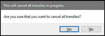

4. Pressing Esc key closes XnConvert regardless of what it is doing.
It will cancel conversion without any confirmation!

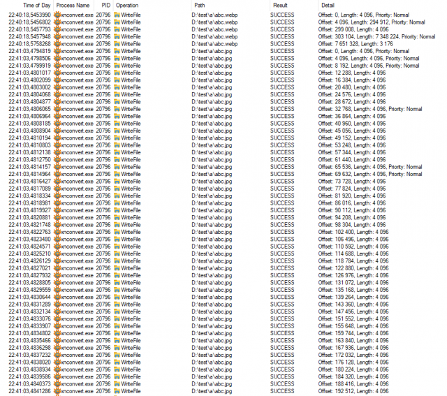

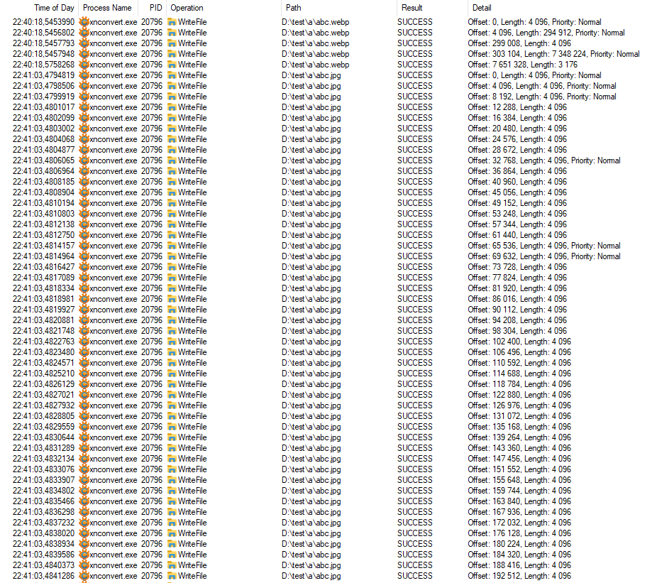

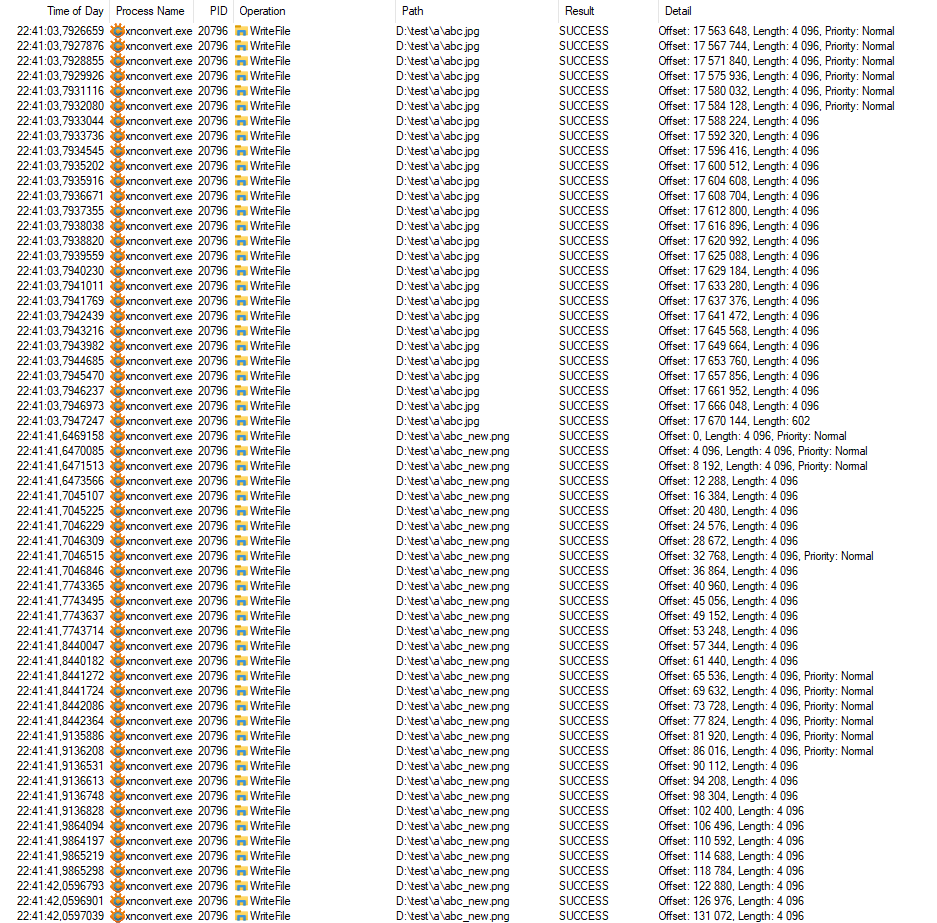

8. When saving files to disk they are written in "4 KB" chunks.
You can see this in that screenshot above, Write operations write to that file in 4096 bytes chunks. This isn't really a very big issue since most of the time we are limited by cpu speed, but writing files in small chunks is just not a good practice. You should use at least 128 KB.

yes, need to be changed when 'delete original' is on2. Turning on "Delete original" removes original file before converted one is written to disk.

you means during processing, need to show a confirmation dialog?4. Pressing Esc key closes XnConvert regardless of what it is doing.

Saving in which format?8. When saving files to disk they are written in "4 KB" chunks.

YES, and pause processing when that dialog is shownyou means during processing, need to show a confirmation dialog?

JPG and PNG save file in 4KB chunks, but WEBP doesn't, it saves file in few smaller chunks and then one big chunk. I only tested these 3 formats, here are some screenshots from Process Monitor: And let me add another thing, (although I mentioned this previously in no. 7). When you add files to XnView, they are read twice, first when they are added to listbox, and second time when exif & thumbnail information is read. Process Monitor clearly shows this. And to make matters worse, JPG and PNG are read in 4KB chunks, but WEBP is read in few smaller chunks and one big chunk, so it looks like every format behaves differently. I hope that when you add "Simple list" view, you code it properly and file will be read once and if one switches to different view then xnconvert will load exif & thumbnails.Saving in which format?

It depends on formats.... Why it's a problem?dexter86 wrote: Wed Aug 23, 2023 8:55 pm JPG and PNG save file in 4KB chunks, but WEBP doesn't, it saves file in few smaller chunks and then one big chunk. I only tested these 3 formats, here are some screenshots from Process Monitor:

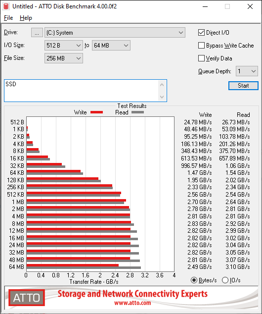

Reading and writing files in small chunks is much slower than when you do this in bigger chunks, even when all files are defragmented, doesn't matter if it's hdd or sdd. And it becomes even worse for NAS over standard SMB protocol (TCP overhead and SMB protocol overhead)It depends on formats.... Why it's a problem?

Ad 2. Confirmed fixed, but there is one small issue, just after writing the resulting file, xnconvert opens and closes source file multiple times before it removes it (You can see this in Process Monitor). It adds very small delay to overall conversion process, but it's negligible.

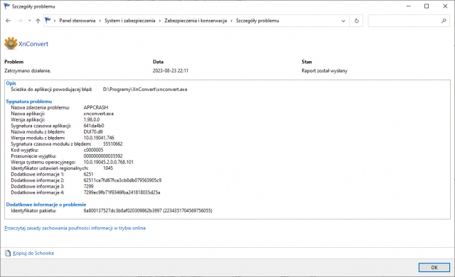

Ad 4. Not fixed, XnView just crashes, i sent you a crash report

Ad 8. Still not fixed, jpg and png files are read & written in 4KB chunks

I can't change the way that format write datas, because some use third party library. And i think that we must keep OS to manage that...Ad 8. Still not fixed, jpg and png files are read & written in 4KB chunks

In 1.6.1, i use QFile::moveToTrash (that uses IFileOperation), and if there is a problem i use this codedexter86 wrote: Tue Oct 17, 2023 4:24 pmI tested it with 1.6.0 because it was the latest version at the time I wrote that post. I just tested this with 1.6.1 and it's still the same, see for yourself https://imgur.com/a/9DvK8gr. Can you at least post here that fragment of source code you use for removal? Preferable the whole fragment with if/case.I can't add more debug, i call a win32 api, that's all. But it's strange, because in 1.6.1, i've changed the method to unlink (without changing focus)
SHFILEOPSTRUCT file_op;
memset(&file_op, 0, sizeof(file_op));
file_op.hwnd = (HWND)parent->effectiveWinId();
file_op.pFrom = lpFrom;
file_op.fFlags = FOF_ALLOWUNDO | FOF_NOCONFIRMATION; // | FOF_SILENT;
file_op.wFunc = FO_DELETE;
bool is_ok = SHFileOperation(&file_op) == 0 && file_op.fAnyOperationsAborted == 0;
Ok, but in XnView 1.6.1, when you press ESC, you should have a warning dialog?I used the same settings like in that video above. You can use the same settings like in that video and during conversion just switch to any other opened app and hold Esc key. XNConvert doesn't even need to be active, it will still crash.I can't reproduce. Do you have actions? do you use multi threading? Which output format?
libpng / libjpegWhich library you use for jpg and png?I can't change the way that format write datas, because some use third party library. And i think that we must keep OS to manage that...

Nevermind that, it's working fine!In 1.6.1, i use QFile::moveToTrash (that uses IFileOperation), and if there is a problem i use this codeIf i remember correctly, i've tried FOF_SILENT flag without change for users with the problem... But i can send you a version to test...Code: Select all
SHFILEOPSTRUCT file_op; memset(&file_op, 0, sizeof(file_op)); file_op.hwnd = (HWND)parent->effectiveWinId(); file_op.pFrom = lpFrom; file_op.fFlags = FOF_ALLOWUNDO | FOF_NOCONFIRMATION; // | FOF_SILENT; file_op.wFunc = FO_DELETE; bool is_ok = SHFileOperation(&file_op) == 0 && file_op.fAnyOperationsAborted == 0;
I used 1.6.1 portable with default settings, so it tried to use recycle bin, but I have recycle bin disabled for every partition. And when I enabled recycle bin for that partition it now works ok. And after that, I disabled recycle bin for that partition and changed in ini "useRecycleBin" to false, and it also works fine
Esc key now works fine after those fixes I've written above. Previously that weird removal dialog box hijacked focus and that caused a crash when I was holding Esc in another aplication. Now you only need to unify "Esc" behavior and "Stop" button. Both should behave the same and show onfirmation dialog "Cancel batch processing" and when user click on Yes it should just cancel batch, instead of closing whole batch window. And another thing to fix, you should pause batch when that "Cancel batch processing" dialog box is displaying.Ok, but in XnView 1.6.1, when you press ESC, you should have a warning dialog?
