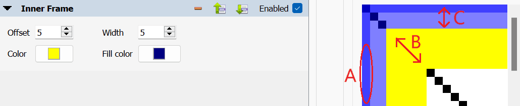

issue A
there is 1px solid line of Offset color
there should be no such line
issue B
Inner Frame grows in both direction when Offset >0
Inner Frame should always grow inwards only
issue C
Offset is overlapped by Inner Frame as a result of issue B

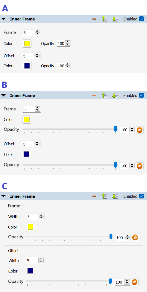

- add Offset Opacity slider
- maybe add Frame Opacity slider as well
- slightly regroup controls

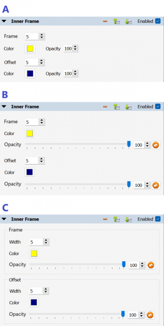

few mockups

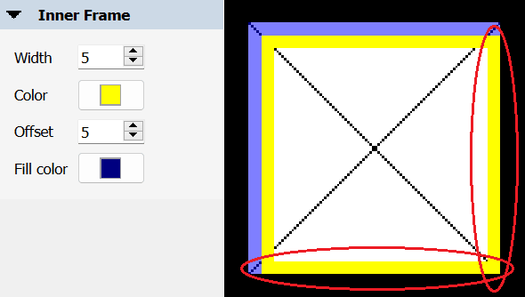

issue D
incorect sizing of frame right and bottom sides

160b
D - fixed
