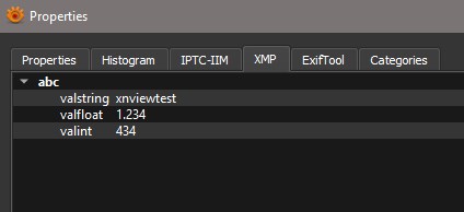

However I get no results when examining the images with XnView->Properties-> XMP there are fields a.b.c with a score value > 10.0 which indicates XnView is reading the metadata. What am I doing wrong with search?

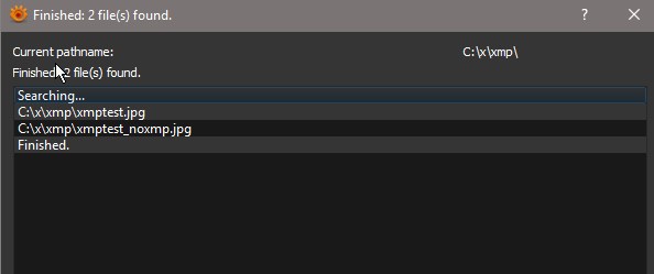

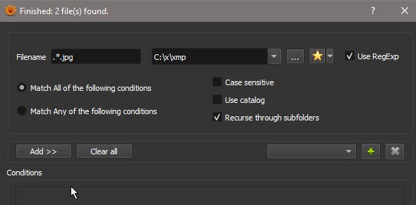

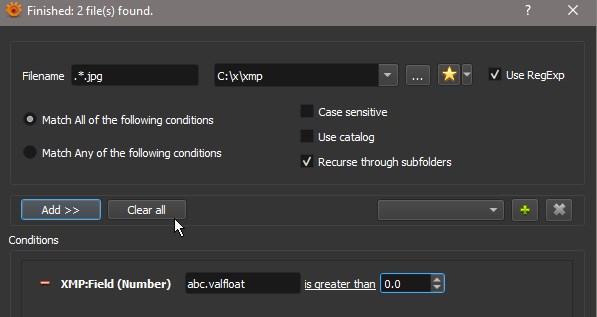

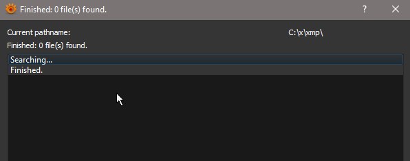

  • Please find a test image without and with XMP data, along with screens shots of the search input and result.
  • The search value box for numbers only allows a single digit after the decimal point, could that field size be increased to support 6 digits after the decimal place?

Re: XMP search custom namespace question
you must search for 'abc:valfloat'
