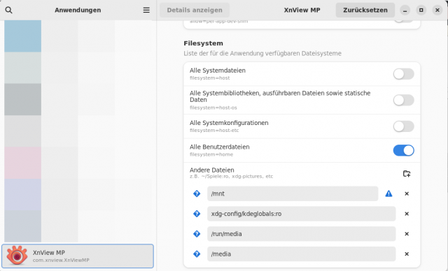

Edit 1: my /mnt is not shown in XnView
installed via flatpak, looks like the same problem like this -> viewtopic.php?p=176248#p176248
But i have no idea where to add the --filesystem parameter or make "the one checkbox on"

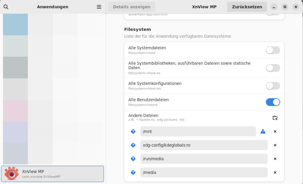

Edit 2: Okay, found a solution for the mounted nfs files. indeed, the flatpak app is preventing access to /mnt
i installed flatseal and added the /mnt folder to the allowed folders
the buttons are now working for the nfs mounts
smb path is still not working, working on this now
