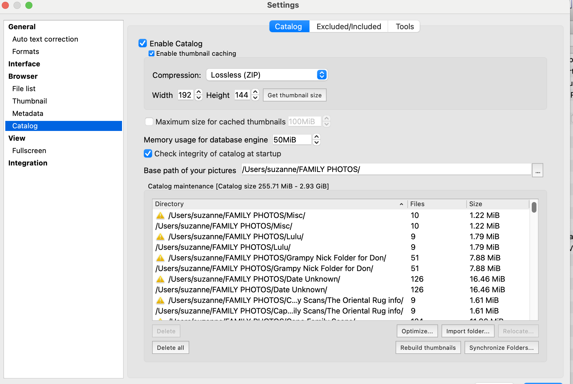

Suddenly, I opened XnView and it seems all my photos appear twice! But when I open in Finder - there is only one.
How can I fix this?
Duplicates in XnView but not in my files

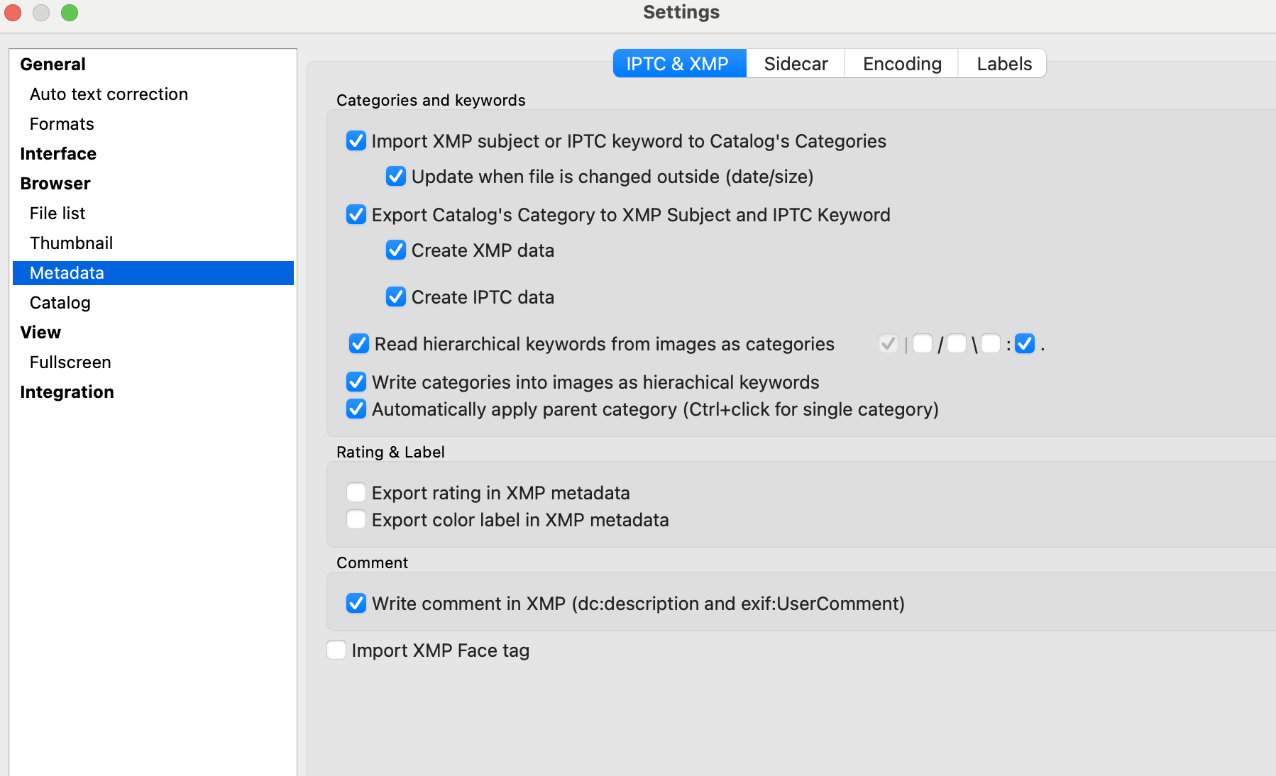

So I've taken a couple of screenshots
1. my settings>Metadata>Export that you mention - does this look like it should?
2. Is this "the table with used folders" that you mention. It does look like everything is duplicated, doesn't it. Can I just delete every other entry? (Actually I tried this with a couple of them, but it didn't fix it.)

Settings metadata:
Your settings are correct.
So each category of a photo corresponds to a keyword, written in the photo, in a standardised way in the iptc and xmp zones.
Xnviewmp and other software that can read these datas will allow you to take advantage of this informations.
(If you want to add star ratings or color labels to your photos , you can also enable these export options so that they will also be saved in metadatas)

Settings catalog
Yes, this table. We can see duplicates. I don't know which of these methods is best to use:Is this "the table with used folders" that you mention. It does look like everything is duplicated, doesn't it. Can I just delete every other entry? (Actually I tried this with a couple of them, but it didn't fix it.)
- Delete "base path" (let only \ in this field ) ?
- Delete all lines with a yellow warning in the table ?
- Use "Optimize" button, (with only delete empty or non-existent files and folders options) ?
- Delete the whole catalog (delete all) and use "Add folder" button (... select usesr/suzanne/family photos/ ) to rebuild the whole catalog.
Maybe the safest thing to do is to wait for a reply from Pierre ...
