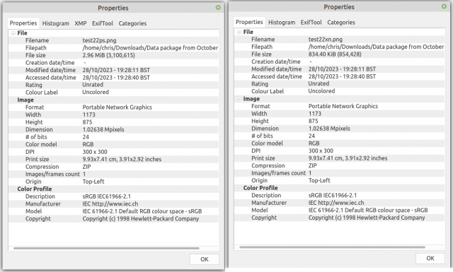

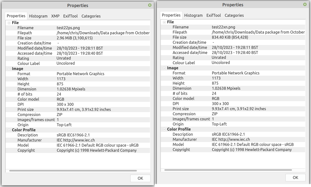

These are the file properties of the PS and XN files displayed in XnView MP:
All displayed properties do indeed look identical, except that the PS file has an additional tab displaying XMP metadata stored in the file... :idea:
One small qualification, the compression type ZIP is displayed, but not the compression level, not sure whether that can be determined.
Deleting the PS file XMP metadata reduces the file size to 847KiB, almost identical to the size of the XN file. :D
[Updated]

I used PngOptimizer to combine the IDAT chunks and to remove all ancillary chunks from test22ps.png as well as test22xn.png:
Optimizing test22ps.png (OK) 3100615 bytes -> 845889 bytes (27% of the original size)
Optimizing test22xn.png (OK)  854428 bytes -> 845889 bytes (99% of the original size)
According to Compare It!, the optimized versions of test22ps.png and test22xn.png are identical.
Posts: 6578
Re: Different sizes of PNG
cday wrote: Sat Oct 28, 2023 7:05 pmDeleting the PS file XMP metadata reduces the file size to 847KiB, almost identical to the size of the XN file.
TweakPNG and PNG file chunk inspector agree that the iTXt chunk in test22ps.png (which contains the XMP metadata) is only 17'356 bytes in size.
It seems to me that test22ps.png was saved with a compression level of 0 (no compression).
Posts: 4619
XnTriq wrote: Sat Oct 28, 2023 8:15 pm It seems to me that test22ps.png was saved with a compression level of 0 (no compression).
That would certainly make sense of the difference in file sizes of the original PS and XN-saved files referred to.
A pity that PNG compression level isn't displayed in the XnView MP file properties display, do you think that the value could be determined and possibly added?
