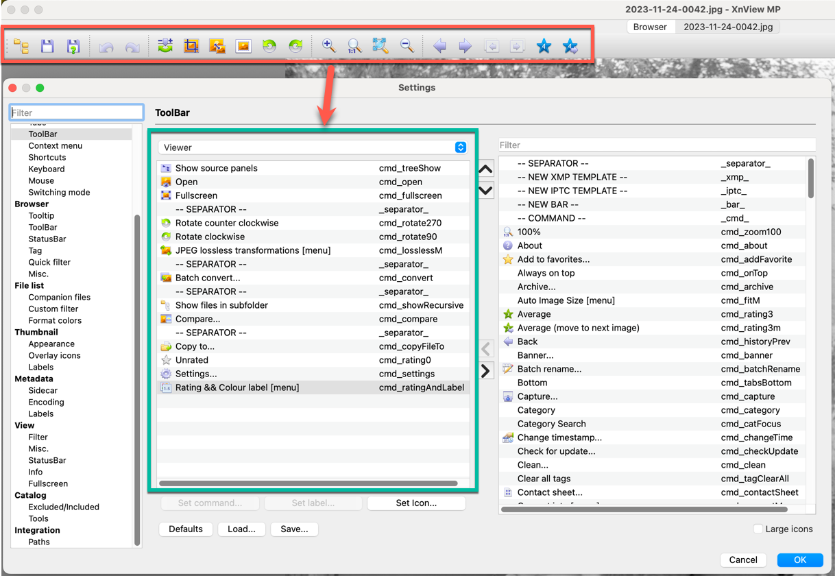

I have a strange problem with version 1.6.2 64-bit under macOS and the toolbars. I have changed the toolbar in viewer mode in an earlier version (red box in the attached picture). If I want to change the toolbar in version 1.6.2, the icons of the browser mode are displayed in the selection (green box in the picture).
If I try to add a new function from the right, the toolbar is overwritten with the other icons. I also cannot rebuild it because several functions (e.g. save or save as) are missing in the selection on the right.
If I cancel the editing process, the previous toolbar configuration is retained and I can use it without restriction.

But you show toolbar of browser but settings>Toolbar show viewer toolbar???

Yes, and when I switch between the two toolbars, the entries for the viewer toolbar also change again. Here is a short video to illustrate the problem: https://youtu.be/Z3_i95xyZGo

This problem is supposed to be fixed in XnView MP 1.6.3. Please check and confirm the bug fix here.

Yes, this error has also been fixed. Thank you very much.
