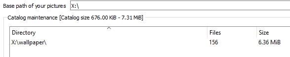

I set a base bath for my pictures and start browsing, which works just fine and leads to the following view:
The xnview.db opened with e.g the SQLite-Database browser also looks as expected - fine:

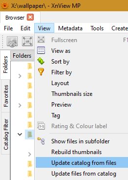

As I often add/change/delete/amend the e.g. xmp-dc:subject, I need to update the files, already in the catalog.
I do this via the view-menu with 'update catalog from files'.

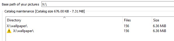

Now the problem - this leads to the following view of the catalog:

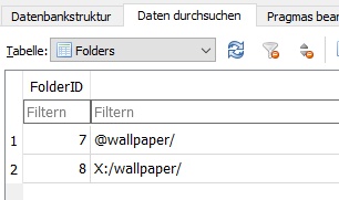

The database looks like this:
So it seems, that the 'forced update' does not respect/consider the set 'base path of your pictures'.
Is it a :bug: or am I missunderstanding anything or am I 'doing it wrong'
