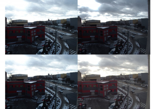

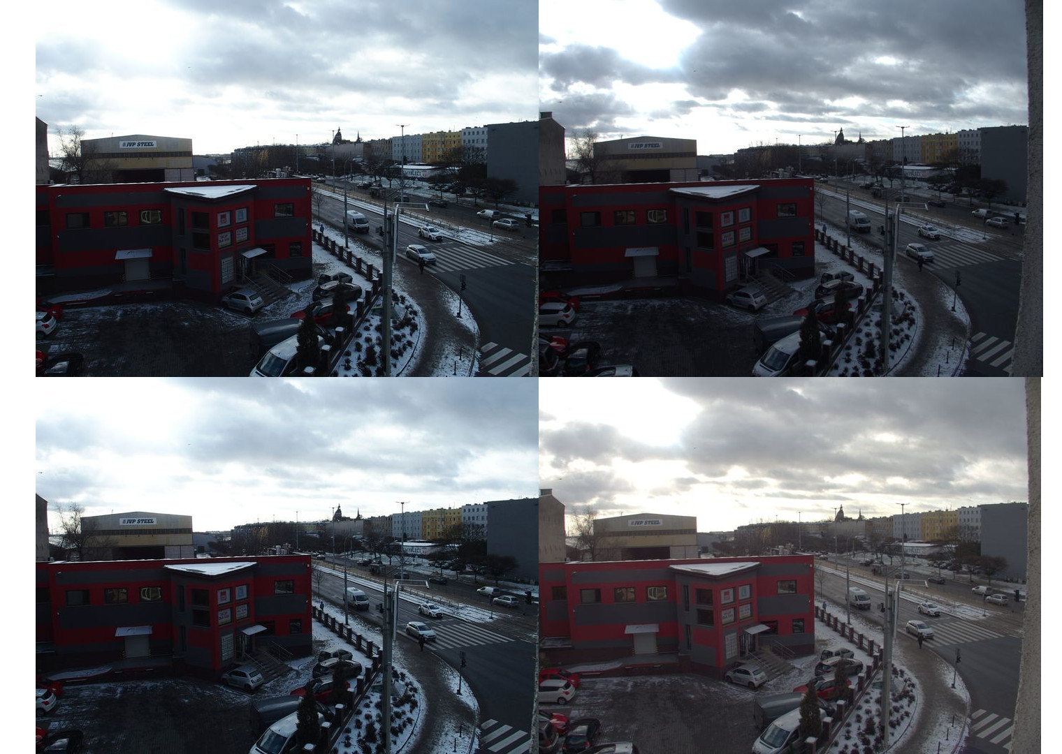

Hi, I found this thread looking for a solution to the problem that I encountered yesterday.
The OP didn't specify the OS or software version they were using, but if that was Linux, and if the Linux version of XnView relies on dcraw, that might be the problem.
I first batch-converted my ORF files to JPG using XnView MP 1.6.4 64-bit (Linux) - Libformat 7.170 on Linux Mint Cinnamon 21.3 and noticed a drastic colour change, barrel distortion and different frame/crop size. I thought it was XnView, found this thread and decided to use a different tool. So I used dcraw, but the result was the same except the colours were a bit truer to the original. I decided to switch to Windows and the results were fine there.
In my attached montage file, the image versions are as follows:
left upper: original ORF
right upper: batch convert with dcraw (note the colour change, barrel distortion and wider frame format)
right lower: batch convert with XnView MP on Linux (note the even further colour change, barrel distortion and wider frame format)
left lower: batch convert with XnView MP on Windows 10 (practically the same as original)
I hope this helps and let me know if I can provide any more info. Thanks for the great tool that XnView is!
- Posts: 48645
Re: ARW
No more usedrodia77 wrote: Mon Jan 22, 2024 7:21 pm The OP didn't specify the OS or software version they were using, but if that was Linux, and if the Linux version of XnView relies on dcraw, that might be the problem.

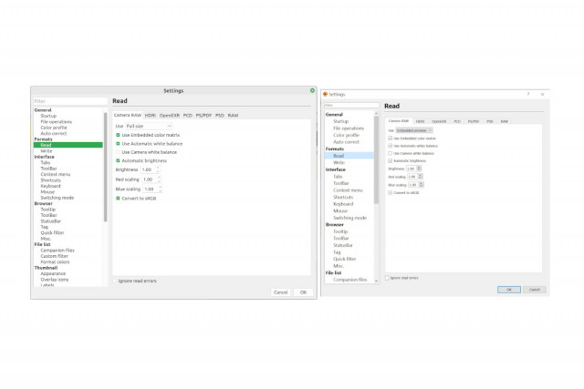

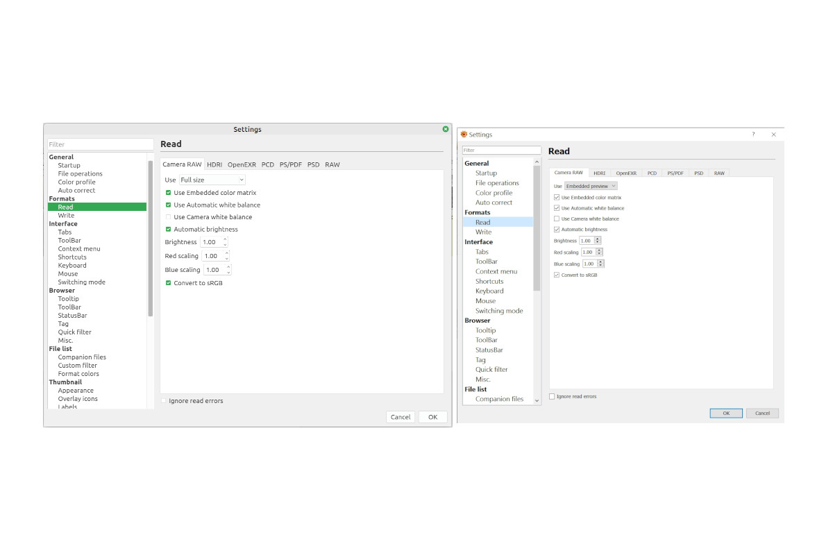

Do you have same settings in 'Read>Camera RAW'?In my attached montage file, the image versions are as follows:

Re: ARW
Nope, it was Full size in the Linux version vs Embedded preview in Windows.
After changing to Embedded preview in Linux, the result got in line with the expectations, thanks!
