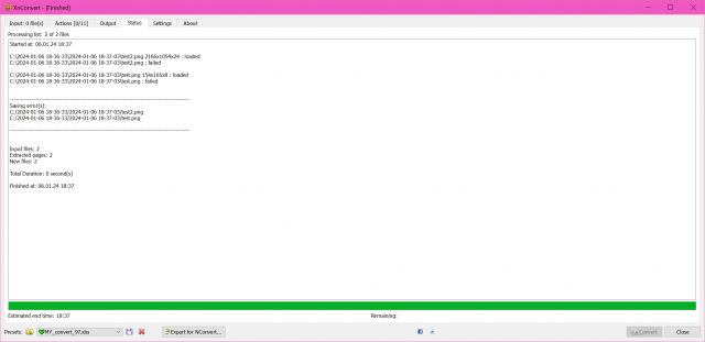

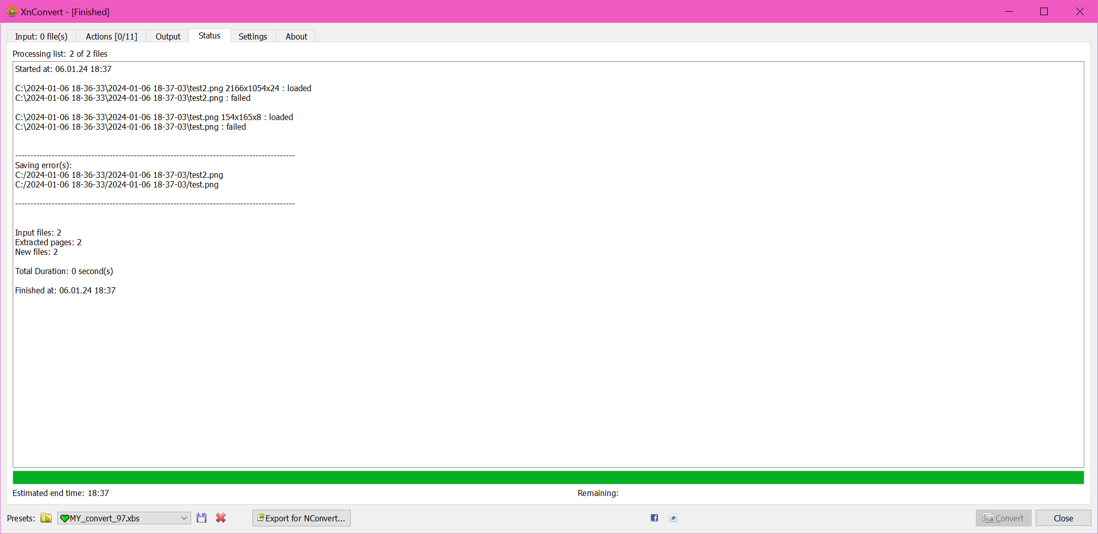

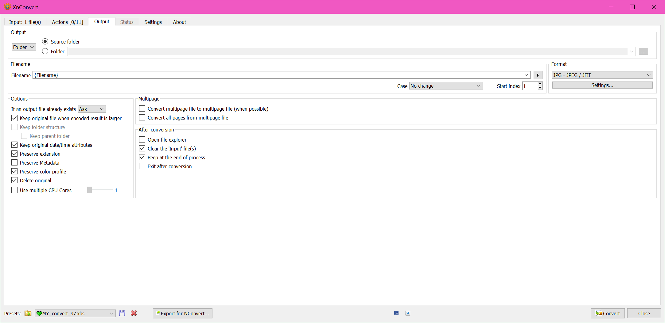

1) My results with "Keep original file when encoded result is larger" are pretty underwhelming... if not say more!
  • (XXX to JPEG format conversion) JPG file was converted with a LARGER size (original file should be preserved, as it was smaller)
  • (XXX to JPEG format conversion) PNG file was deleted permanently :shock:, not even placed in the recycle bin (original file should be preserved, as it was smaller)
  • (XXX to JPEG format conversion) AVIF file was deleted permanently :shock:, not even placed in the recycle bin (original file should be preserved, as it was smaller)
2) Also i found one tiny flaw in the preset system - if "Keep original file when encoded result is larger" option state (ON or OFF) is not saved in the Preset file (checkFilesize="false" or checkFilesize="true") then it will be used from INI file. So you need to update all your presets if you want to use that option in some, but not all of them.

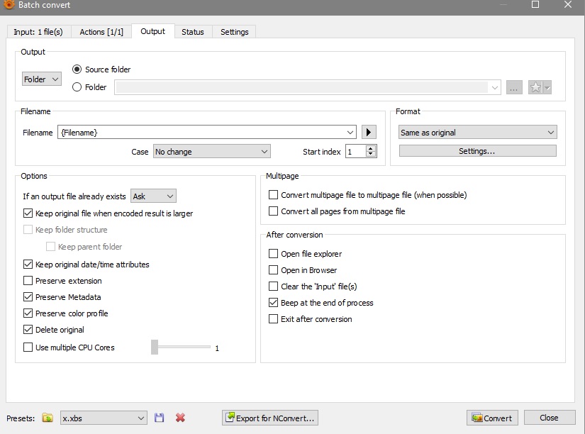

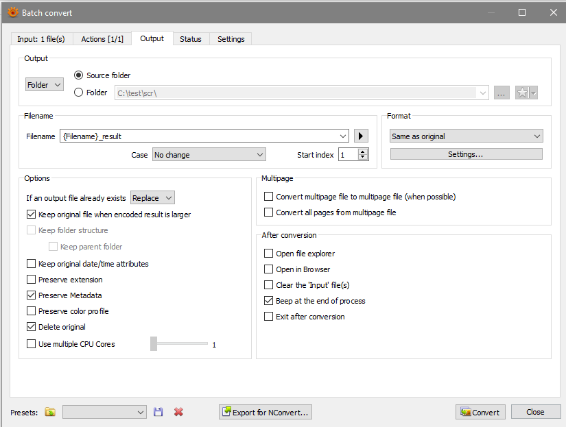

xnview wrote: Sat Jan 06, 2024 10:11 am Please post a screenshot of 'Output' tab? Do you have actions? and files to reproduce?
Eh, i juts realized that i forgot to post my output tab. :mrgreen:
Posts: 47033
Re: Bug: "Keep original file when encoded result is larger" may delete your images permanently
please disable 'preserve extension'?

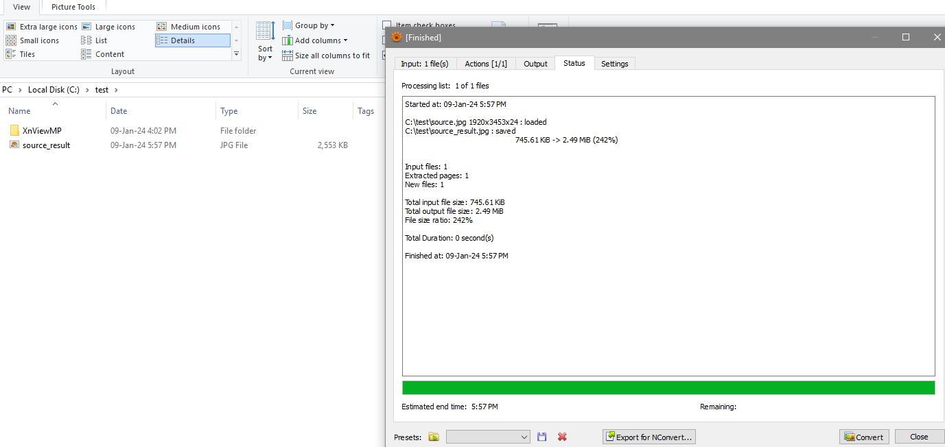

Post by snowfl »
xnview wrote: Mon Jan 08, 2024 7:11 am please disable 'preserve extension'?

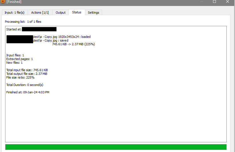

I am also getting this bug, original file size is 745 KB and new one is 2.37 MB and original file is getting deleted.

Post by snowfl »
Still not working, i also removed the xnview config ini to make sure nothing carried over from old version.

Yap it was removed. I downloaded xnview few days ago to reduce the resolution (1920px) of older files, good thing i tested this before using it on the actual files.
Some of these files was downsized to 1920px long time ago so i don't want these files to be modified/deleted but xnview increases its file size and deletes the original.

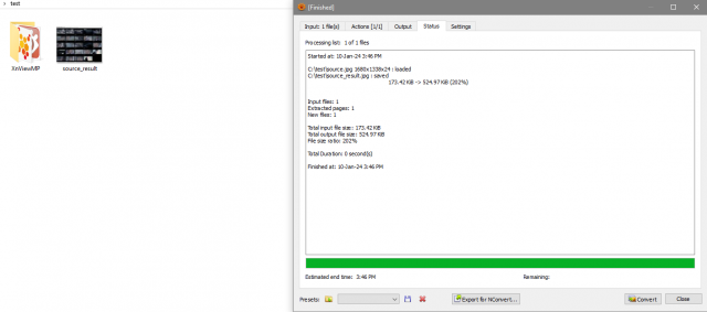

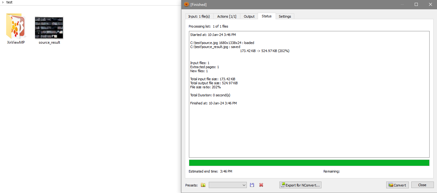

Post by snowfl »

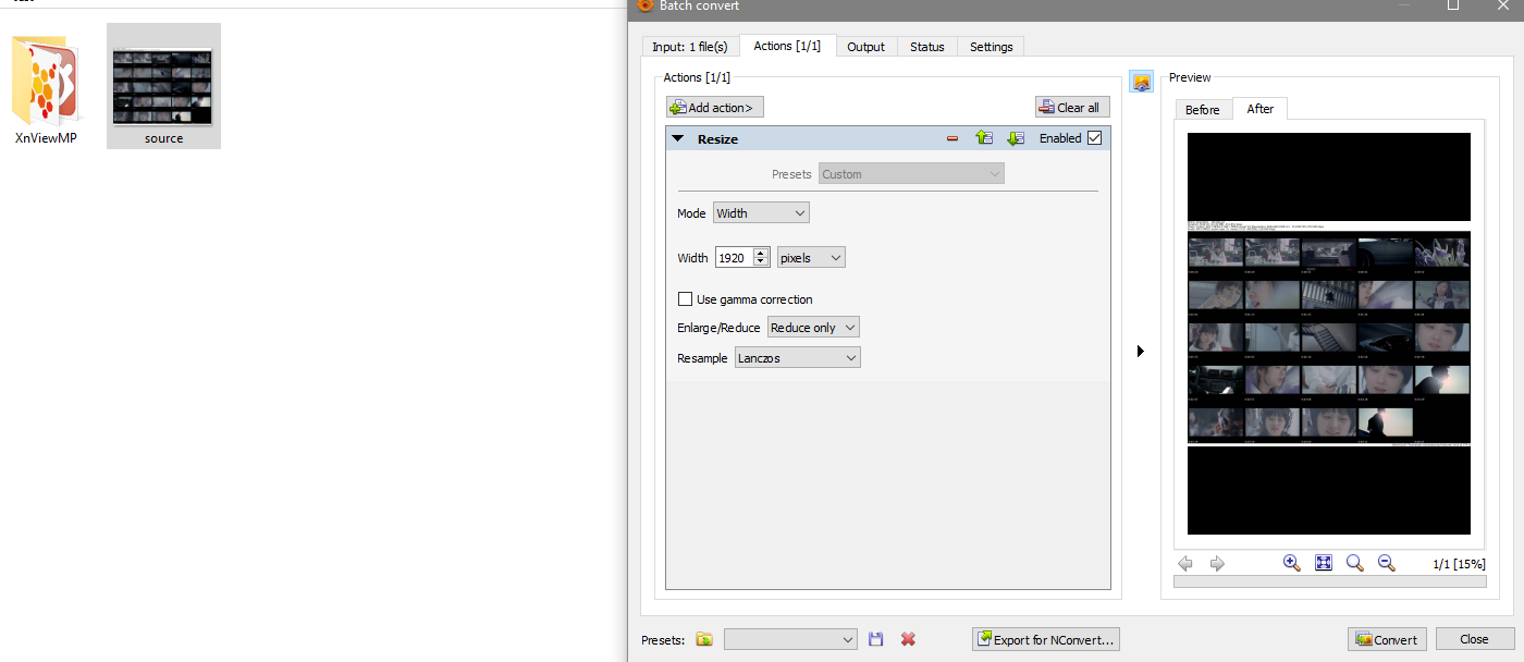

Previous test file is private file so i used another file.
Total input file size: 173.42 KiB
Total output file size: 524.97 KiB
File size ratio: 202%

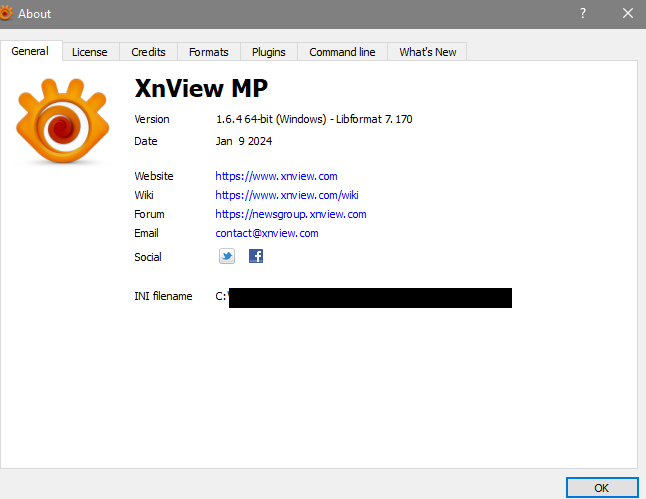

xnview wrote: Tue Jan 09, 2024 9:56 am This problem is supposed to be fixed in XnView MP 1.6.4. Please check and confirm the bug fix here.
Hmm, i tested it again in 1.6.4 and it seems to work fine? I am still a bit scared to use this new function, so i will do more testing later.
