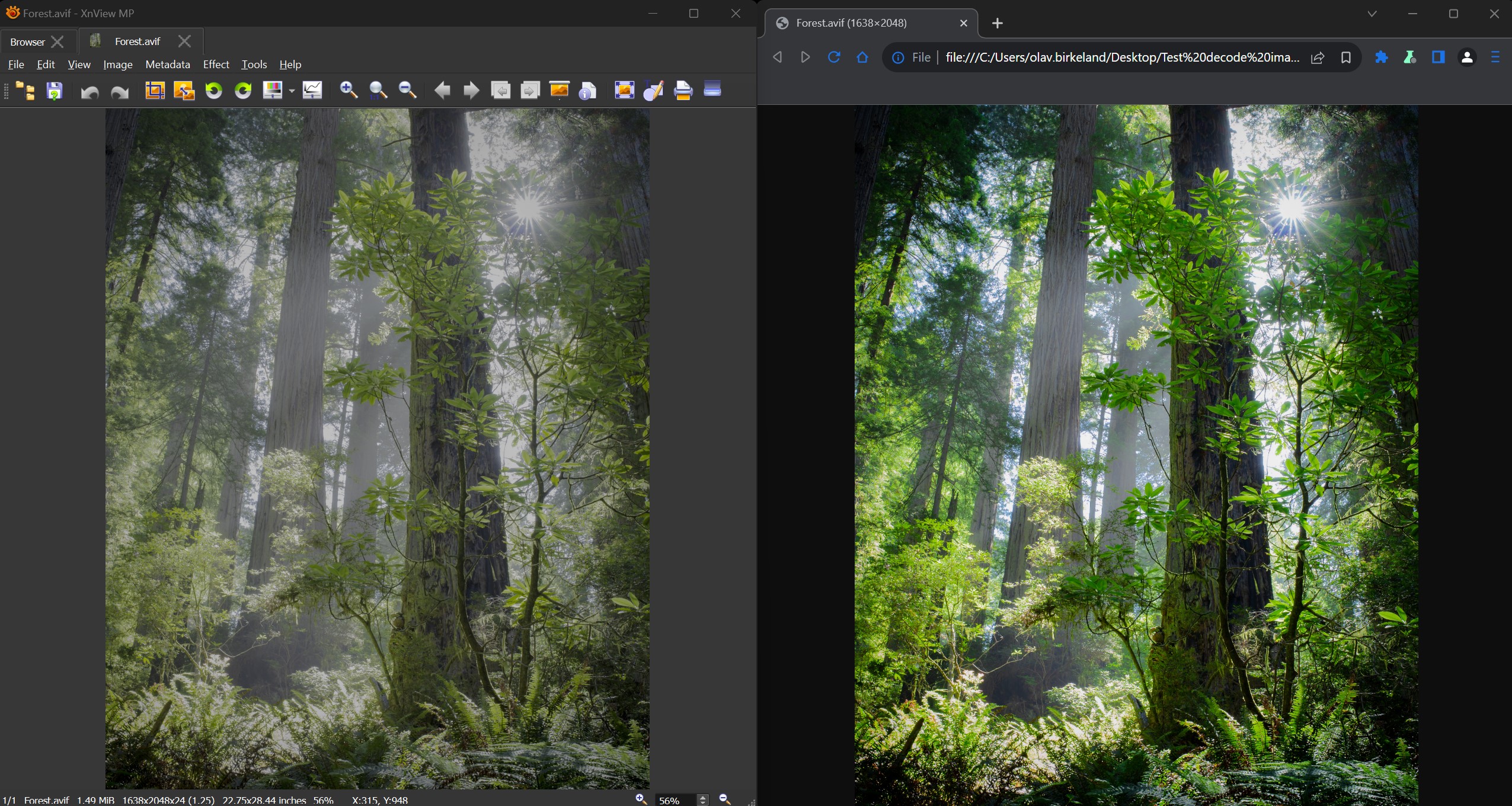

Sample HDR AVIF image that looks dull / wrong when opened with XnView MP v1.6.4 with Tools -> Settings -> General -> Color Profile -> Use ICC Profile for monitor enabled.
Found here:
XnView to the left, Thorium browser v121 to the right.
The same issue but with JPEG XL (JXL) was reported and fixed here:
Posts: 47709
Re: Does XnView supporting HDR AVIF/JPEG XL?
AVIF uses libheif, and no metadata like ICC is return...
