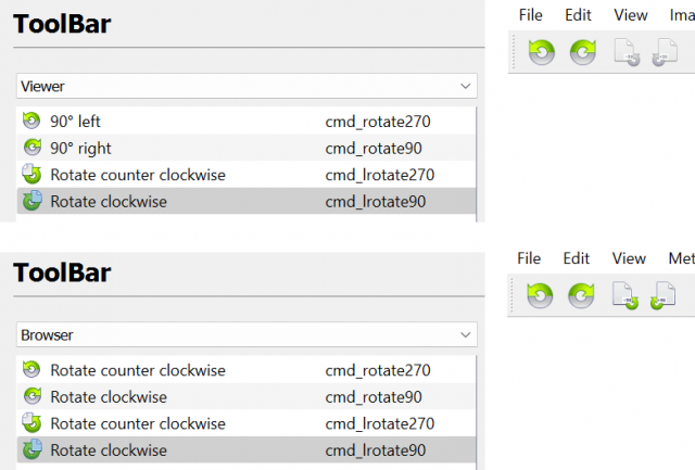

Please, would you make these ICONS for the lossless operations also available for the Viewer's toolbar:
Rotate clockwise - cmd_Irotate90
Rotate counter clockwise - cmd_Irotate270
Currently they are just available for the Browser's toolbar (while commands exists without icons for the viewer's toolbar).
Also, I like to ask for creation and including an icon for cmd_Icrop (the commands is available for the viewer's toolbar, but without icon).
Would be very nice, thank you in advance.

Re: Lossless Icons for the Viewer's toolbar
Don't worry, the configurable toolbars would allow you to stay with the user interface as you are used to it, while others could benefit from improvements.user0 wrote: Fri Dec 29, 2023 6:22 am I doubt its good idea to add 2 specific buttons to the default toolbar.
No no, this cumbersome "one more click"-workaround already exists. The improvement would be to have frequently used advanced features at your fingertips, or only one mouse click away.
In my tool bar I have been activating cmd_Irotate90, cmd_Irotate270 and cmd_Icrop since ever, but with blank buttons. 10 years ago I improvised my own button icons, but unfortunately it was not persistent against updates.
My suggestion to the highly respected author is to create and include the missing icons. This would unleash the power of these functions, that have been lying dormant in submenus.
If I'm not mistaken, …
- cmd_flipH
- cmd_flipV
- cmd_rotate90
- cmd_rotate270
Didn't bother to update to the current version or do a clean install?cw2002 wrote: Fri Dec 29, 2023 9:22 pm In my tool bar I have been activating cmd_Irotate90, cmd_Irotate270 and cmd_Icrop since ever, but with blank buttons. 10 years ago I improvised my own button icons, but unfortunately it was not persistent against updates.
icons have been available since at least version 1.5.5
This was good advise, thank you. I had to hide my XnViewMP roaming folder beforehand of the update installation, to get the new icons.user0 wrote: Sat Dec 30, 2023 5:43 am ... do a clean install?
I do find these icons quite useful. The update history proves me right that it was a good idea to ask for them.
