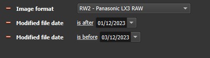

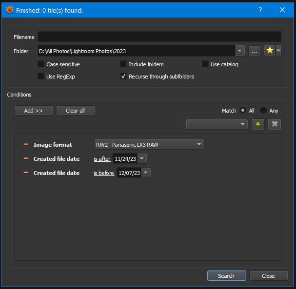

Strange search behavior noticed with older and latest (v1.6.4) app. If I search for RW2 files in a particular folder, I get the expected result (many files show up in the results windows). If I add a Created File Date is "after" a particular date, again I get the expected subset of results (.rw2 files created after that date). If I change that Created File Date to "before a particular date, again I get the expected subset of results. HOWEVER, If I use a date range:
- Created File Date is "after" 11/24/23
- Created File Date is "before 12/07/23
...whether or not I use the Image Format is "RW2", no files are found.
Perhaps I'm not using the Search dialog correctly? Assistance would be appreciated. Thank you!

The search "between two creation dates" DOES work. However, adding the Image Format of RW2 results in zero files found (even though, in Windows Explorer, it shows 150 .rw2 files in the target Folder within that date range. Changing the Format to JPG works (for JPG files, of course, not RW2).
Searching only for Format of RW2 in XnView results in zero files found regardless of where I search or whether I use Creation Dates or not. It seems XnView is not recognizing RW2 files (or at least the ones from my camera - GX85, a model from 2016).

I had selected RAW9... ...instead of RW2. I saw "Panasonic Raw" and thought that was the proper format. No, my target files are RW2 so the issue is strictly one of user error. Not only that but the screen shot I included in my original post showed the correct format choice but wasn't what I had used for my (failed) search.
