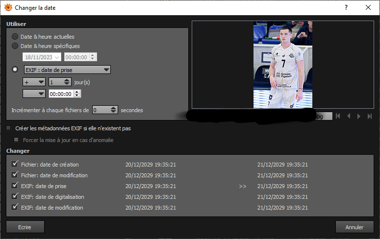

You can change the date without changing the time.
Just add +/- the number of days.

Select a few JPG photos
Metadata > Change timestamp menu :
- You can select EXIF:Date taken as source (or another existing date)
- Then add ou substract some days. Leave increment at 0
- Select only the dates you wish to update at the bottom
Use the > or < buttons to display the modified dates for the sequence of photos...
Each photo will be processed with it's own timestamp, with the offset you have set ...

Re: Change date without affecting the time
Ok I may not have understood but I try one last thing.
With this option, if you change the date, the time doesn't change.
Look at the result on my screenshot, the hours don't change.
In the Drop-Down Menu, you can choose which date is to be modified.
