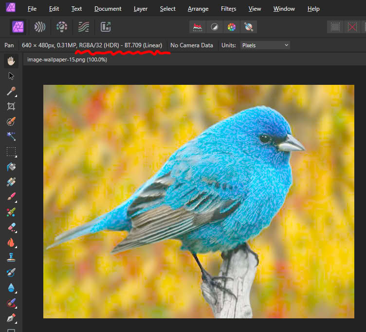

Recently I updated to XnView version 1.7.1. Now when I save any 8-bit sRGB image as PNG or TIF, they open as 32-bit images with BT.709 (Linear) profile instead of opening with the same bit depth and profile as the source files (8-bit sRGB). Does anyone else have this problem? This didn't happen with the previous version I've been using. 1.6.x

Sure, please see attached. When I save the 8-bit .JXL image from this ZIP as PNG or TIF, it opens as 32-bit image with different color profile in Affinity Photo 2.4.2. No, I didn't have this problem with XnView MP 1.6.4.

Post by superconductor »
Yes, with 1.6.4 everything is fine, but with 1.7.1 when the JXL is saved as PNG/TIF (File > Save as) it opens as 32-bit image. Screenshot attached.
