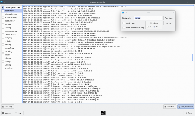

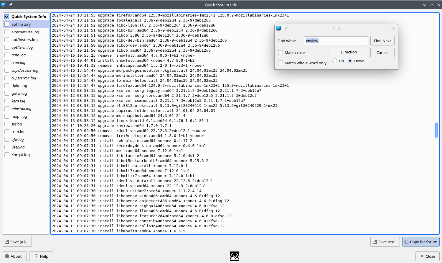

I am willing but don't know how, I am a gui only guy most of the time. If you could provide some instruction or a link to instructions I will do it.
Trying to switch to linux full time but still learning.
update:
MX Linux has a utility called Quick System Info which allows access to some log files. Screenshot attached. I can use the find feature to search for the info that you require if you let me know what to look for.
update:
