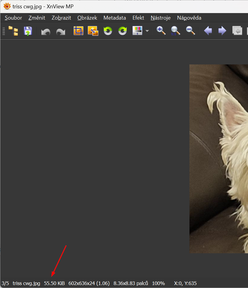

When viewing images in detail, and stumbling upon a video (mp4/mkv), the filesize is not updated in the statusbar. Filesize of last image is shown instead.
Effect: Filesize on images is not updated in statusbar
1. Open a detail of image
2. Use mousewheel to toggle to next file, until it is video
3. The file size is not updated since last image

I view an image, size is shown correctly. Then I use mousewheel to switch to next file - and if it is a video, the filesize is incorrect.

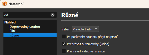

I do have a separate video player (MPC-HC), but I'm using the xnview's builtin video player here. It has autoplay enabled if that matters.

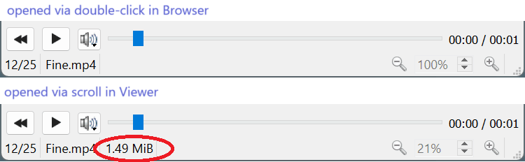

I can confirm the bug
it depends on the way you open video file:
