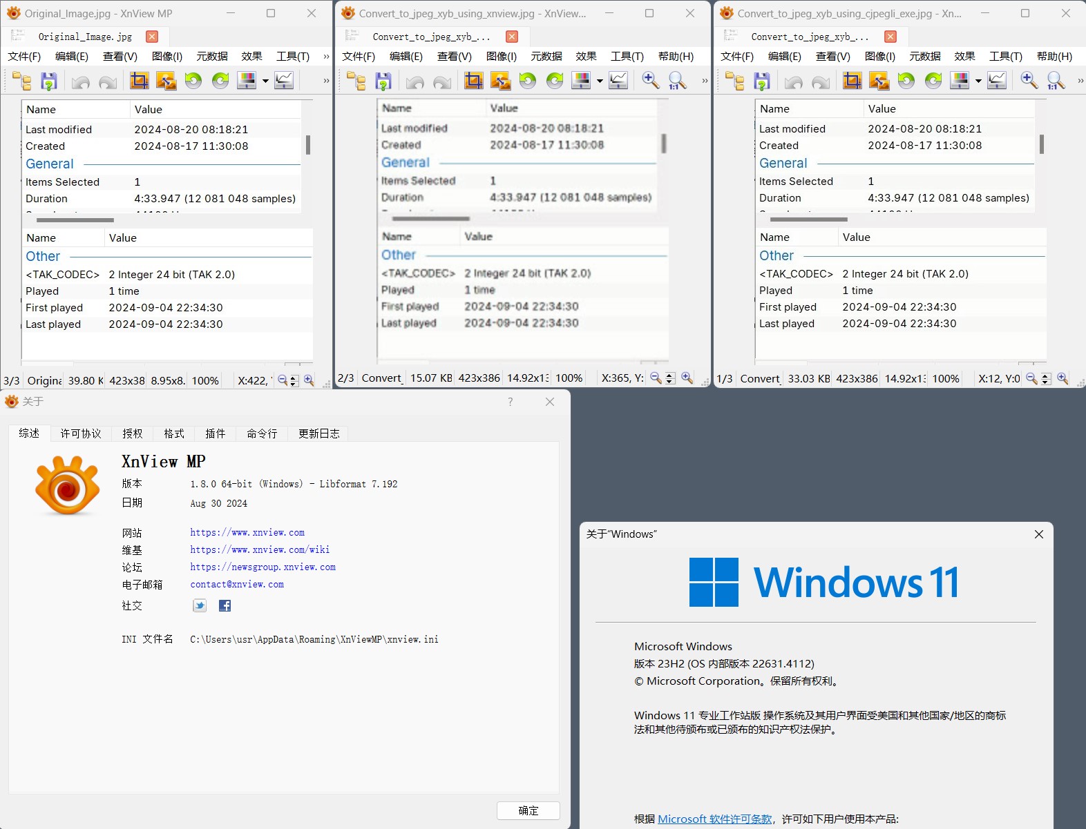

XYB cororspace images created by XnView MP using JPEGLI encoding are very blurry.
See the screenshot, below.
On the left is the original image.
In the middle is the image created by XnView MP (check Convert to XYB colorspace in Options).
On the right is the image created by cjpegli.exe, a command line tool provided by libjxl.
It can be seen that the quality of the image created by XnView MP is not good.
Windows 11 23H2 x64
XnView MP 1.8.0 64-bit
A sample image will be attached below:

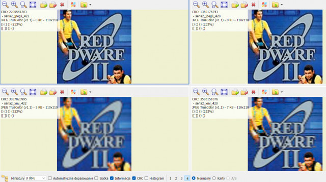

You set in XnView coding 2x2, 1x1, 1x1.
Look on file size and info about file.

Kadet wrote: Wed Sep 04, 2024 4:26 pm You set in XnView coding 2x2, 1x1, 1x1.
I'm not sure if this is the key to the problem as cjpegli.exe also saves Subsampling as 2x2,1x1,1x1.
I set the quality to 90%, but the quality of the output image is still poor, as you can see from the screenshot of the file size, or by downloading the sample image.
The file size saved by Xnview MP is 15KB, the file size saved by cjpegli.exe is about 33KB, and the original image is about 40KB.

You have right. When in XnView is set 2x2 where is some bug. But 1x1 give the same image as in cjpegli.
Posts: 47040
Re: 1.8.0: (JPEGLI) XYB cororspace images created by XnView MP using JPEGLI encoding are very blurry.
4:2:0 is inversed with 4:2:2

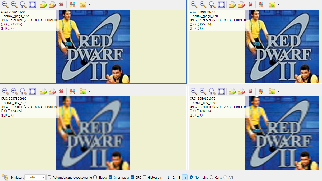

No, problem still is. Settings 422 and 420 give the worst compression against to cjpegli.
And 422 give 420 in output file, and 420 make 422 jpeg file.
Source file:
Edit: I set quality on 91.
Posts: 47040
Kadet wrote: Thu Oct 10, 2024 7:08 pm No, problem still is. Settings 422 and 420 give the worst compression against to cjpegli.
I have the same as cjpegli, it seems that you dont use --xyb

xnview wrote: Fri Oct 11, 2024 6:43 am
It doesn't make a difference if I used or not xyb in XnView — yesterday.
But today you are right, there is a quality difference whether I set xyb in XnView, I forgot to set xyb in cjpegli and now I have basically similar results (the difference of a few bytes is due to the newer version of cjpegli).
Sorry, I may have mixed something up yesterday.
