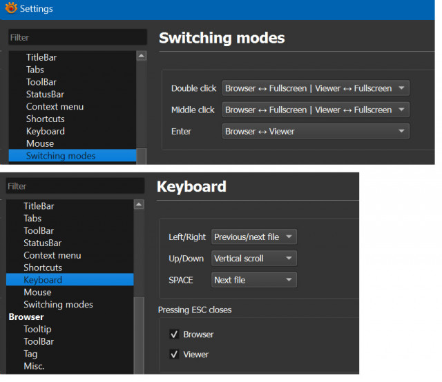

I'm using XnView MP 1.8 on a Windows 11 PC and would like to customize the Esc key behavior.
Here's my current setup (see attached image) and desired outcome:
Current behavior:
- When I open an image from Windows Explorer, it opens in fullscreen mode (as I've configured).
- Pressing Enter opens the browser view.
- Pressing Esc in fullscreen mode returns to the viewer (not full screen, the one with the menu) and I have to press Esc again to exit.
Desired behavior:
- I'd like XnView MP to exit completely when I press Esc while in the browser view.
Could you please advise if there's a setting to achieve this behavior? I've tried different settings but haven't found a solution.
Thank you for any suggestion.
M.

This is the flow:
1. I open a picture from Windows Explorer
2a. If I press Esc, it exits (even though it's not very smooth, there's a sort of quick flash)
2b-1. If I press Enter, it goes into browser mode
2b-2. If I press Esc, it doesn't exit immediately (as I'd like) but it goes in viewer mode (full screen picture with menu)
2b-3. I have to press Esc again to exit completely.

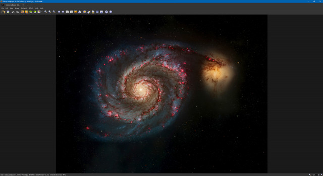

could you post a screenshot?Matt1972 wrote: Mon Sep 09, 2024 4:21 pm 2b-2. If I press Esc, it doesn't exit immediately (as I'd like) but it goes in viewer mode (full screen picture with menu)
Matt1972
- Posts: 17
- Joined: Wed Feb 10, 2016 2:27 pm
Re: Switching modes
Yes, of course.
This is the screen shot taken after I press Esc from the XnView browser.
When I press Esc again it exits.

- Posts: 48628
Re: Switching modes
i've tried. Open an image file from windows explorer, image is opened in fullscreen, press ENTER go to browser mode, press ESC nothing
It's normal 'Settings>Keyboard - ESC' for browser is not selected
- Posts: 3109
Re: Switching modes
there is no "exit on Esc" functionality
Esc only closes tabs, when there are no tabs left - app closes
to close app with multiple tabs use Ctrl+Q
