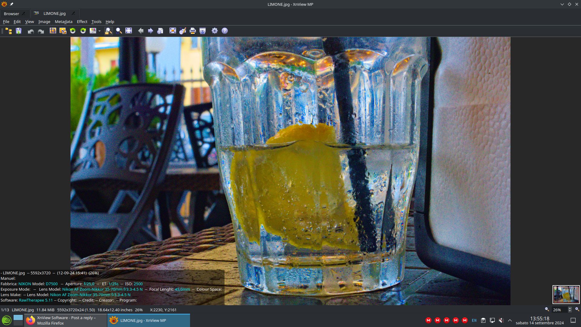

not, i wish add information in INFO by exiftool:
LENS ID, FOCUS MODE, ETC, ETC..
see example my custom in INFO: i see xnviewmp i can't add parameter from exiftool, EXIF,Makernotes, etc)

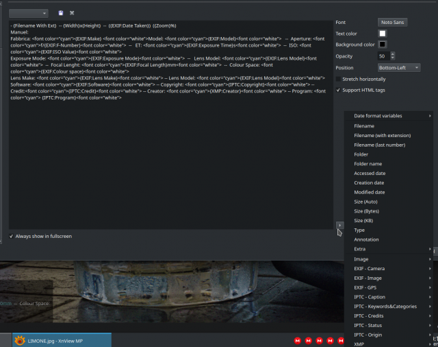

Re: [EXIFTOOL] why not add in INFO>>Setting?
In your screenshot, the "Info" shown in view mode is linked to Tools>Settings>View>Info (you can use I key to toggle shown/hidden info in view mode)
In this settings screen you can edit the informations shown and add many exif fields by using the black arrow at the bottom right of the large field.
"Information panel" with iptc, xmp, exif, exiftool tabs is something different, used to show these informations in browser mode.
You can get the same panel with a right click>Properties on a photo in view mode. This one is easy to resize

YES, correct INFO from setting>>view..infomichel038 wrote: Sat Sep 14, 2024 12:31 pm In your screenshot, the "Info" shown in view mode is linked to Tools>Settings>View>Info (you can use I key to toggle shown/hidden info in view mode)
yes but there are not: EXIFTOOL in FIELDS...this is missing EXIFTOOL...In this settings screen you can edit the informations shown and add many exif fields by using the black arrow at the bottom right of the large field.
this is from PROPERTIES, i don't like this because every time I have to do too many click click clicks, it bothers me a lot and makes me nervous = huge waste of time"Information panel" with iptc, xmp, exif, exiftool tabs is something different, used to show these informations in browser mode.
so
if xnviewmp will add EXIFTOOL in FIELDS to setting>view>info = faster show me info in View..absolute faster..
EXIFTOOL is missing in FIELDS see picutre:
ExifTool is not the name of metadata fields, it's a (great) software that can edit or show almost all metadata ...yes but there are not: EXIFTOOL in FIELDS...this is missing EXIFTOOL...In this settings screen you can edit the informations shown and add many exif fields by using the black arrow at the bottom right of the large field.
XnViewMp provides already about 70 Exif fields , and its sometimes possible to call some exif fields withe their number, such as :
{EXIF:x010F} displays exif Manufacturer
{EXIF:x110} displays exif Model
{EXIF:x112} displays exif orientation
but with {EXIF:x10B} i can't see anything
Which fields do you need to be displayed ?
