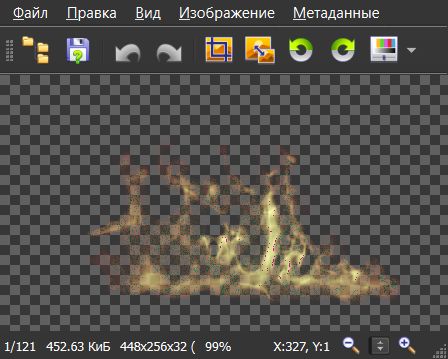

Some files (EXR specifically) often contain color in a premultiplied format. It would be nice if XnView had an option to display them as such. Currently, a fully-additive premultiplied EXR (e.g., containing only an additive fire in color but a fully transparent alpha channel) is displayed as fully transparent.

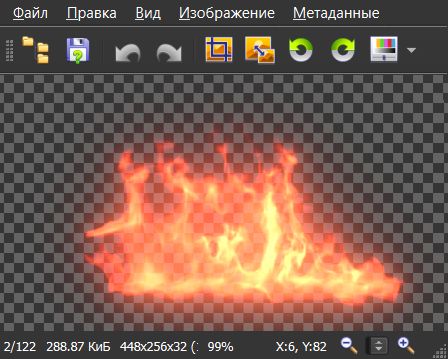

I'm attaching an example image. It contains a fire with very transparent alpha, but a lot of glow in RGB. It should be drawn as very bright mostly-additive (but partially opaque, too). Instead, it's displayed by XnView as barely visible and very dark (a well-documented effect of double pre-multiplication).
How it should be displayed:
What SHOULD be displayed
The current XnView behavior:
What's actually displayed now
