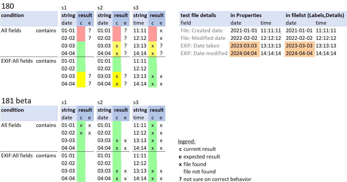

having trouble finding dates/times as advised here
0. test file (modified date need to be updated once saved)
Issue A
1. open Search dialog (default settings, no checkboxes checked)
2. add single criteria, search string and run search
  • All fields
    - does not search in File Created/Modified fields (red)
    - finds in EXIF Date Taken/Modified fields (yellow)
    expected behaviour
    not sure where exactly 'All fields' supposed to search (yellow):
    • all available fields
      OR
    • 'File:All fields' only
      since there are separate 'EXIF/IPTC/XMP:All Fields' conditions, then, following this logic, there should also be 'All Fields' and 'File:All Fields' conditions
  • EXIF:All fields
    finds as expected, the only question about delimiter in date (yellow)
181 fix/clarification:
- 'All fields' search in EXIF, IPTC, File fields
- need to use dash(-) and semicolon (:) separator when searching in date
Issue B
Why is a semicolon (:) used internally as separator for dates?
It either should be:
- dash(-) as in ISO8601 OR
- whatever user set in OS settings, dash in my case

Issue B
EXIF date are string and use :

fixed in 181
