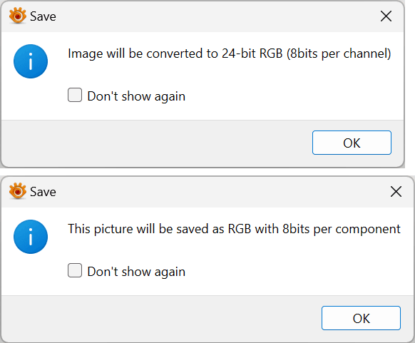

XnViewMP 1.8.2 64bit
Viewer - save
0. have 2 files in folder: raw (eg cr2) and not raw (eg jpg)
1. open JPG file and press Ctrl+S
Confirm save dialog appears - OK
- press No
2. scroll to RAW file and back to JPG
3. press Ctrl+S
conversion warning will appear
(sometimes old test is used in warning)

The meaning of the two text versions differs:
The first text - improbably - implies that the source image will be converted to a 24-bit image, although that is not what is meant.
The second text correctly states that the image will be saved to a 24-bit RGB file, but ideally would also include the first text's '24-bits per component' text.
Suggested better wording:
Image will be saved as 24-bit RGB with 8 bits per component
Posts: 2662
Re: 1.8.2 - viewer - save - conversion warning appears after raw
1st part - OK
2nd part - I prefer "(8bits per channel)", with parentheses
bps - bits per component/channel/color, all of which are synonyms
I just don't see any reason to use 'component' only in this one place when all menus/commands use 'channel'.

How do you have the second dialog??
Posts: 2662
xnview wrote: Wed Oct 16, 2024 3:19 pm How do you have the second dialog??
don't know.. it happened a few times in the test folder, but after I deleted it, I can't reproduce it on other files :(

This problem is supposed to be fixed in XnView MP 1.8.3. Please check and confirm the bug fix here.
Posts: 2662
183
fixed (conversion warning does not appear at all)
