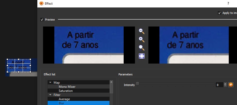

I have a photo of a page of text. I want to blur out some sensitive words. I use the following procedure, based on experience from other tools. Nothing happens. Am I missing something??
1) select the text area I want to blur (click and drag to create the selection box)
2) choose 'effect' / 'effect...', (effect window appears)
3) turn on 'preview' - original image appears in the 'Effect' window, with 'before' and 'after' versions left/right.
4) choose Filter/Blur from the list, and set an intensity of 50%
5) (nothing changes on preview image or base image)
6) turn on 'apply to image' (upper right) - nothing changes.
7) turn off 'apply to image' and instead, hit 'apply' button (lower left) - nothing changes.
8) Hit 'ok' on the filters... box; nothing changes.
Here's a screenshot of my efforts, using XnView's home page as a sample. I selected the words 'Image Viewer' as a test.
I've tried this with numerous 'effects' and none seem to be working so I'm obviously making a dumb mistake.

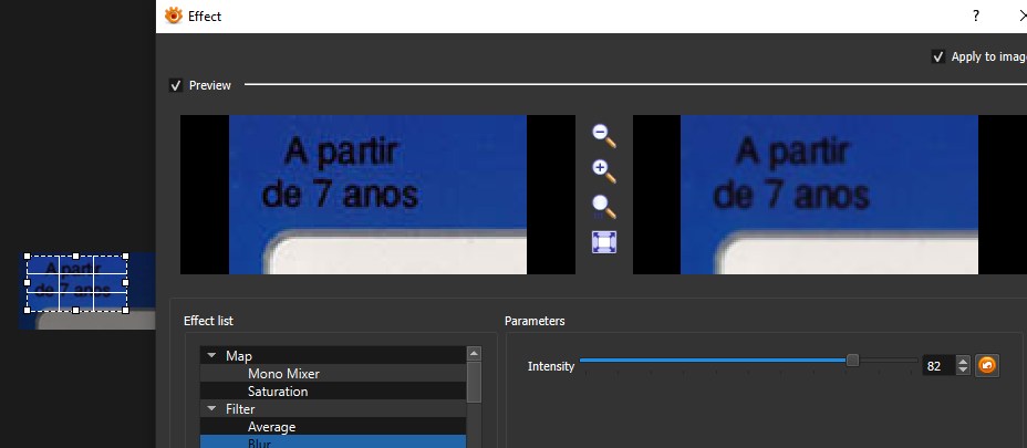

i've tried, and it works.

Thanks. So even at a setting of 82% in your example, the 'blur' is very subtle. I guess that's the design intent - a very subtle blur? I'm looking for a setting (or tool) to completely obfuscate the words, as in this example:
(this was created using the 'gaussian blur' tool in IrfanView at a setting of only 8 (out of 100). I do see that the 'blur' tool in IrfanView is also very mild (like in XnView).
So is there anything in XnView that can achieve this? I tried Gaussian Blur at the max setting of 13x13 but it does not quite obscure the text .

  • Blur
    at 100% has almost the same intense as in Photoshop
however, it worth adjusting other blur filters
  • Gaussian Blur
    at max 13x13 in XnViewMP effect equals:
    - 4px in Photoshop (range is 0.1-1000px)
    - 3px in Affinity (range 0.1-100px)
    It would be nice to have larger range as well, eg 0.1-100px
  • Maximum/Minimum Blur
    I would update it to match Affinity
    - 0-100px range
    - add Circular checkbox
  • Median box (Blur)
    - 0-100px range
    and do something with calculation speed, its too slow
Posts: 48933
Re: Not understanding 'blur' effect
This problem is supposed to be fixed in XnView MP 1.8.4. Please check and confirm the bug fix here.
