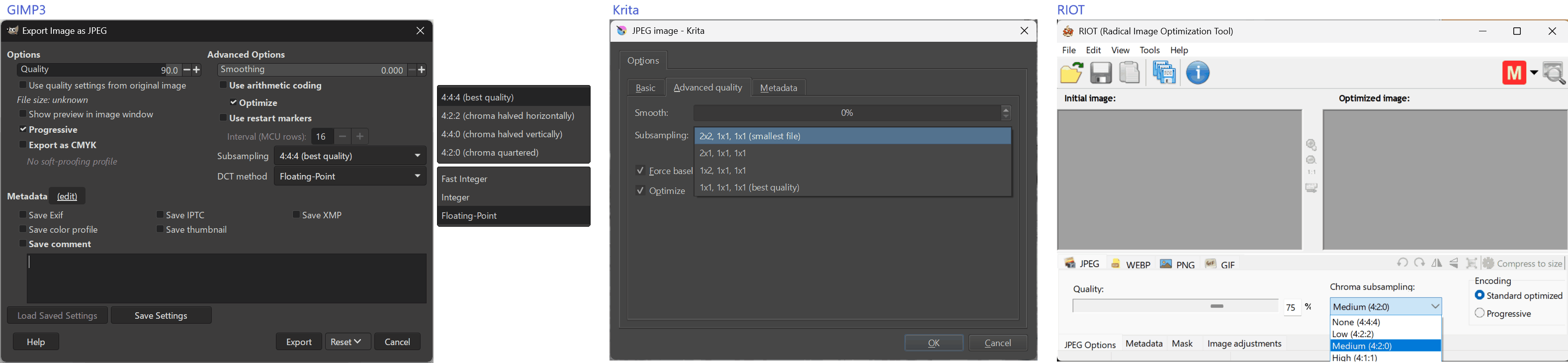

Could the JPEG / Jpegli Subsampling be relabelled so that it is human-friendly and uses standard notation - like so:
It's currently non-standard and confusing for users - e.g. then switches to
Plus, please use the correct name for Jpegli - not 'JPEG-li'
High compression (4:2:0)
Medium compression (4:2:2)
Low compression (4:4:0)
No compression (4:4:4)
'4:2:0 (2x2, 1x1, 1x1) smallest file' Code: Select all

The XNView settings do not need to be an exhaustive tutorial on the technicalities of chroma sub-sampling, so using the most common notation of e.g. '4:2:0' is enough for the user to understand what is being applied.
For the average user, they want to know what effect the setting will have - therefore 'compression' is the clearest description. The Export setting could be labelled 'Subsampling compression' then 'High (4:2:0), Medium (4:2:2), Low (4:4:0), None (4:4:4)' - this is consistent and easily understood by all.
> "smallest file, best quality" are also valid options and clear enough
Switching units for the same function is bad UX. It confuses for no benefit. Be consistent - stick with the compression labelling, as above.
