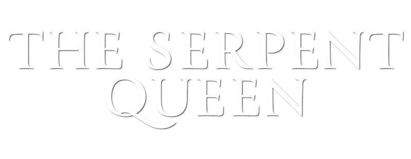

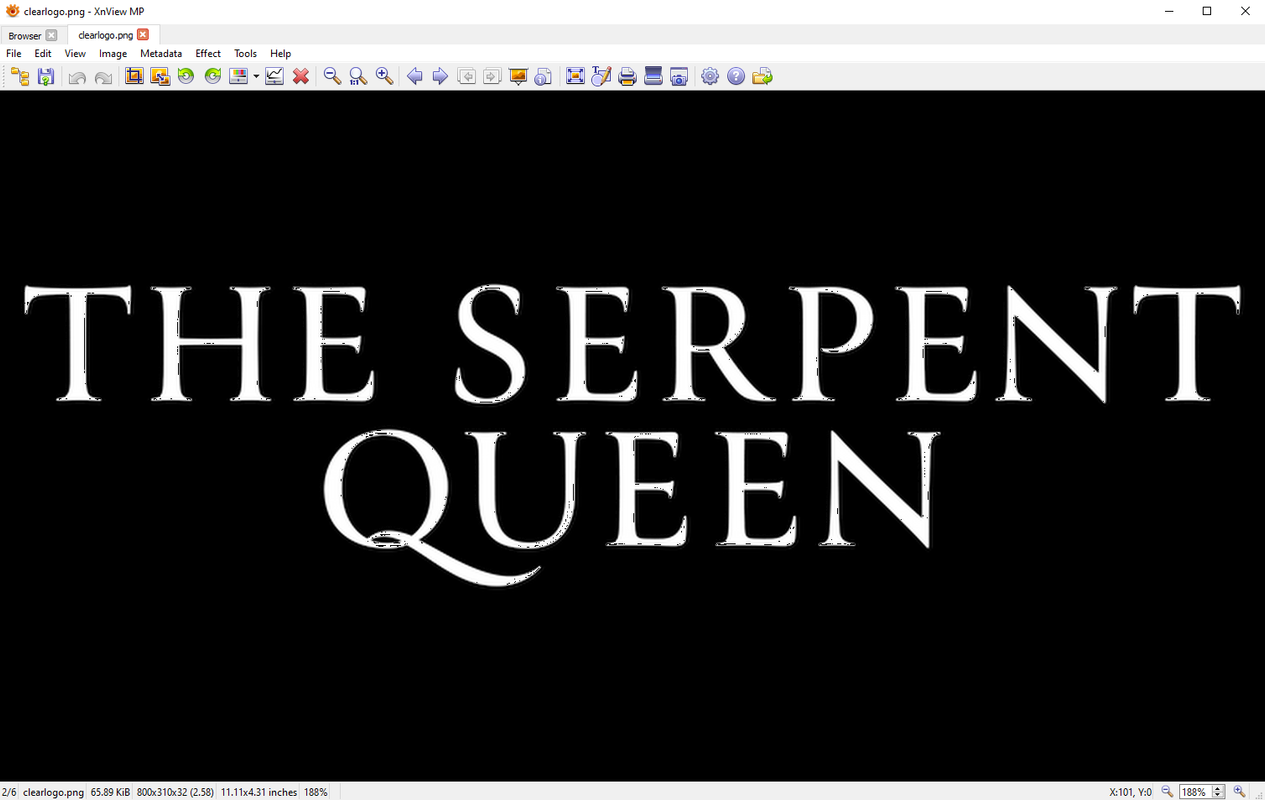

When I view .PNG files with transparent backgrounds, if the zoom is set to 100%, then they display properly with no issue. For example any kind of logo file.
However if I zoom them either up or down by any amount, they are full of weird artifacts.
XnView Classic does not have this problem, it displays the images perfectly without any artifacts no matter what the zoom level is. Just the MP version has this issue. And it's had it forever, since years way back and is still there in the current version.
Could you please fix this so the .PNG's display properly at any zoom level?

Please send the file

You can grab it here:
https://thetvdb.com/series/the-serpent-queen#artwork
Click the "clearlogo" tab...

Posts: 3056
Re: Artifacts when zooming .PNG files with transparent background in MP version
png truecolor+alpha
high zoom quality (any, except None and Bilinear) + zoom
related
1.7.1 - viewer - high zoom quality - border at the edge of transparent png
1.8.2 - view - png - tRNS transparency - viewing issues (test img 10)

Until it's fixed:
Tools>Settings>View
Use checkerboard pattern as background > (enabled)
High Zoom Quality > Make sure "Zoom In" and "Zoom Out" both show "None"
Back in the main Screen, go to View under the title bar. You may have to toggle "Use Alpha Channel" on or off.
