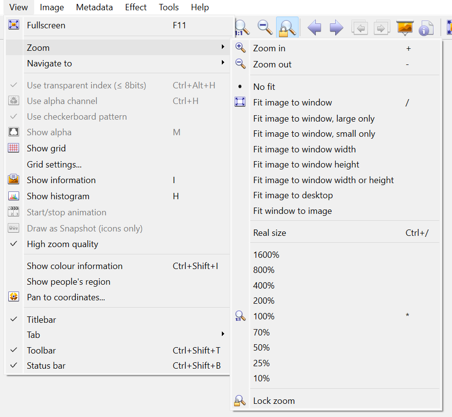

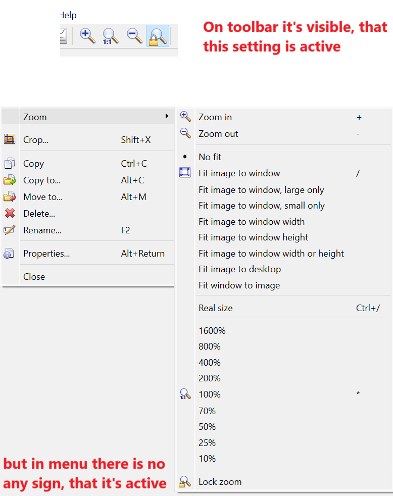

Seems, I was able to find the reason after you mentioned ini file. lockZoom parameter was set to true in my ini file. After changing it to false everything is working as it should, so I was wrong that the bug still exists, sorry.
But regarding lock zoom in the app itself it's very confusing. If I go to View menu (or right-click on my image) and then go to Zoom submenu, there is a 'Lock zoom' item, that always looks absolutely the same, there is no any distinguishment between active and inactive state. But if you add this item to toolbar, there is a rectangle, that shows its state. In context menu there is no any rectangle, and because of that I thought, that this setting is inactive and there is a bug.

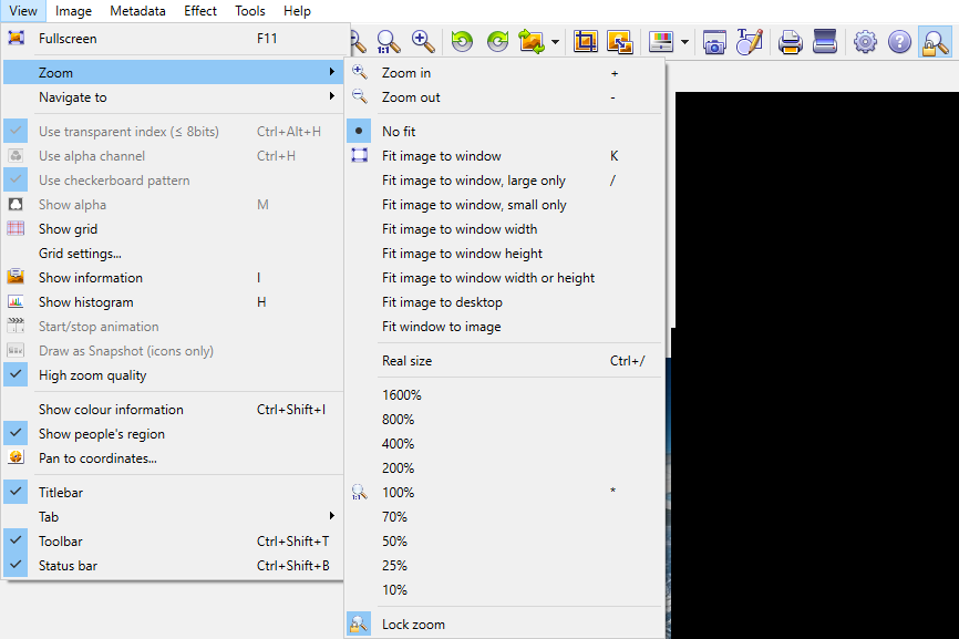

teslasystems wrote: Sat Mar 15, 2025 2:32 am But regarding lock zoom in the app itself it's very confusing. If I go to View menu (or right-click on my image) and then go to Zoom submenu, there is a 'Lock zoom' item, that always looks absolutely the same, there is no any distinguishment between active and inactive state. But if you add this item to toolbar, there is a rectangle, that shows its state. In context menu there is no any rectangle, and because of that I thought, that this setting is inactive and there is a bug.
with 1.8.6? i can't reproduce

xnview wrote: Mon Mar 17, 2025 4:46 pm with 1.8.6? i can't reproduce Clipboard-1.png
Yes, 1.8.6. I don't have this rectangle.
And I see, that on your screenshot there is the same rectangle on 'No fit' option. In my case, I don't have it, only bold dot. Same with other items in menu, there are only ticks on items like Titlebar, Toolbar, etc., but without rectangles.
Posts: 2667
Re: 1.8.3 - View - Auto zoom - Fit window to image
your screenshot is from win10, OP's from win11
app/qt stopped highlighting selected item in menu in win11 for some unknown reason
