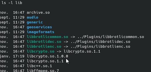

if you put this file into lib of XnView folder

I noticed that I also have libcrypto.so.1.1 in the same lib folder.

Strange, it works here. Do you have that in lib folder
