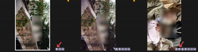

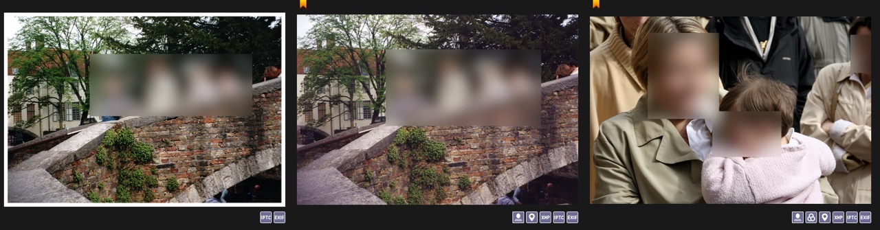

1/ I did the test with 3 files in the same folder, with the catalog activated. Here they are before the operation:

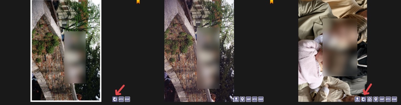

2/ I rotate the thumbnail of each of the 3 files, everything seems OK. I notice that there's a rotation icon only on the first and 3rd. After checking, the 2nd has no camera/orientation metadata in the EXIF data.

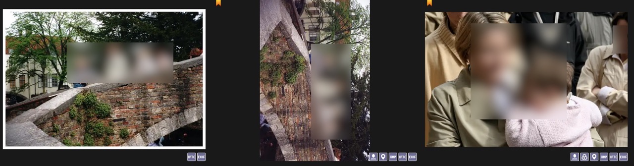

3/ I click on another folder in my catalog and then return to the folder to force a refresh of the thumbnails. Here's the result:
The thumbnails of the two files with EXIF orientations (1 and 3) are not correctly updated. If I open each of the files, however, they are all fine with the rotation performed.
