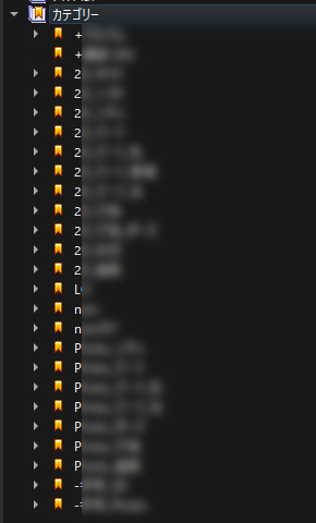

Does it work differently in different languages?
I am using Japanese.
Here is a screenshot.

the sort order is localized

The problem also occurs with clean installations.
Please try to reproduce it with the Japanese version 1.8.5

The problem this time is that 1.8.5 has changed the order of the files at startup from the previous version.
When renamed, the order is the same as in 1.8.2.
I would like the order to be the same as when it was renamed when it was launched.
Because the Japanese sort order in Windows is very complicated.
I don't know the correct answer because I can't find any official documentation.
There are more than 10,000 characters and the order changes depending on whether the second character is alphanumeric, hiragana, katakana, or kanji.

you can add in xnview.ini [%General] localizedSortCategory=false

- Posts: 49081
Re: The order of categories in Catalog Filter is not correct in 1.8.5
There is a change in 1.8.5 with sorting on some languages.
If you want same behavior, you can edit your xnview.ini and add localizedSortCategory=false
