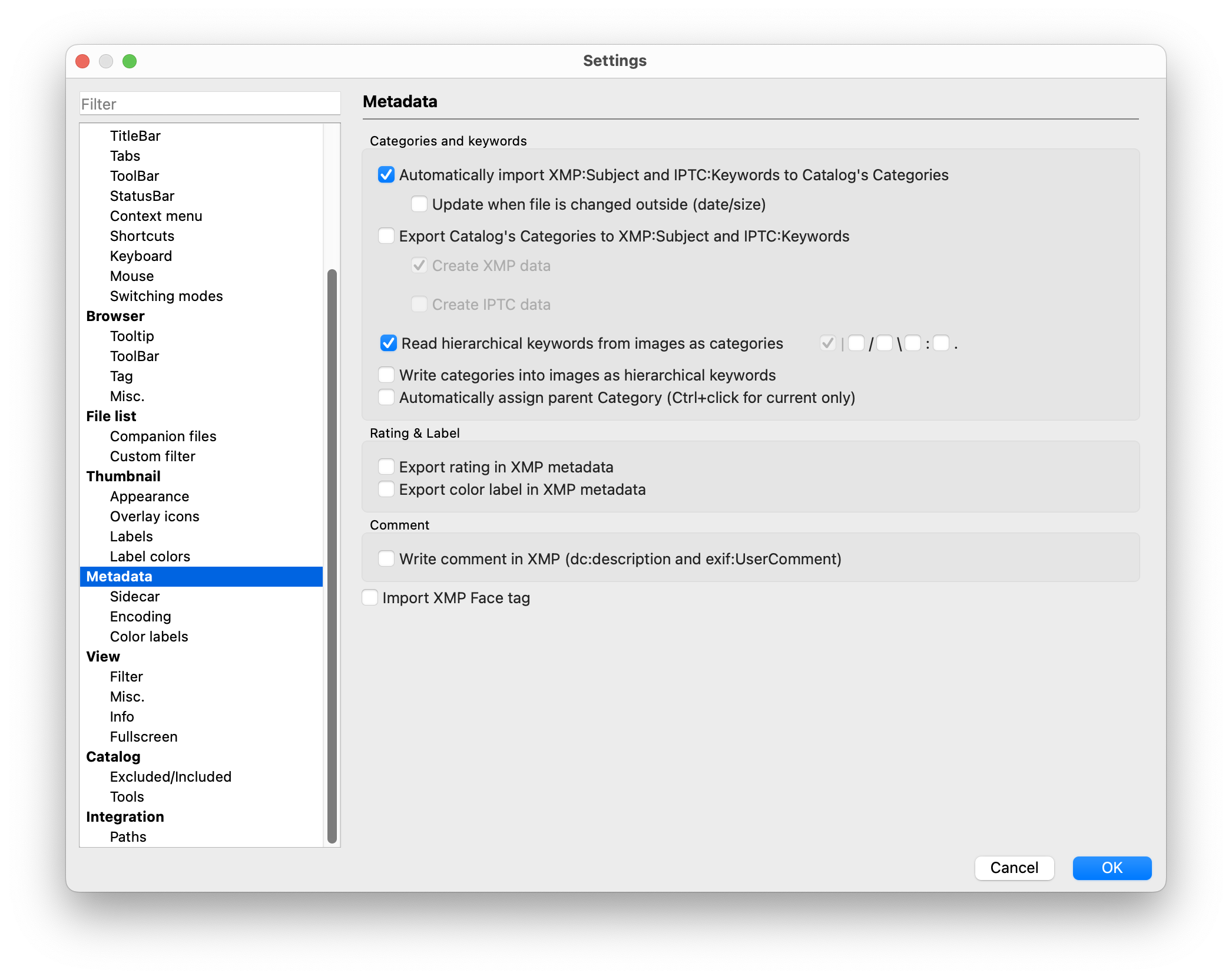

In Preferences>Metadata
There is a check on:
- Automatically import XMP:Subject and IPTC:Keywords to Catalog's Categories
- Read hierarchical keywords from images as categories
SI010|0:0.
Not sure I use the catalog. I usually click on Catalog Filter tab and and click on one of the ratings 5 is the photos I have completed the edit and the other ratings are for photos I have to edit. 1 is the rating for photos I have to delete.
SI010|0:0.

If you'd still like help, please post current screenshots of the following settings screens:
Settings:Catalog
Settings:Catalog:Excluded/Included
Settings:Metadata
Settings:Metadata:Sidecar
I have some ideas as to what may be going on with your situation. The app is not known to just randomly forget information.
Are you using NAS, external drives, or any removable storage for your images?
If you're just announcing your departure, then ok, bye.
Settings:Catalog
Settings:Metadata

I don't have an answer yet, but I will give you a couple of pieces of general advice...
The way you have the app currently configured, it is saving your ratings/etc in the database ONLY. Nothing is written to the files or out to the filesystem in general.
A consequence of this is that you can lose your data in the database (ratings) IF any of the following occur:
1. There is some strange bug in the app that causes a loss of data in the database
2. Your computer misbehaves and causes some problem
3. You personally do something inappropriate.
So for starters I'm going to recommend that you change the following settings:
Settings:Metadata:Sidecar:Create or update XMP Sidecar=ENABLED
Settings:Metadata:Sidecar:Update master file=OFF
Settings:Metadata:Sidecar:Naming convention=filename.extension.xmp
Settings:File list:Companion files:Link companion files for the following actions=Delete & Copy both ENABLED
Settings:File list:Companion files:Show companion files=OFF
I would also encourage you to set Settings:Metadata:Exiftool to Enabled. You're missing out on a lot of functionality without that.
(If you use some other application that uses sidecars (I assume you don't) then you might need to change the Naming Convention setting to match the naming convention used by the other application)
Doing this will ensure that when you rate a raw file, the rating will be also written to an XMP sidecar file on the filesystem. This way, if for whatever reason you lose ratings in the db again, you can recover them seamlessly because they will still be stored in the sidecar files. With the settings I gave you, your master files (the raws) will not be modified unless you explicitly take action to do so.
Once you make these changes, restart the app (just to be safe), and check the settings to verify the new settings are still correctly in place.
If they are, then go ahead and rate one of your raw files. Immediately after you do that, go look at the folder the raw file is in, and you should see an XMP file with the same name as well.

this is not how it works, his JPEGs should have embedded metadatajkm wrote: Fri May 15, 2026 6:46 pm If you delete the db and rebuild now, you'll lose the ratings on the jpeg files
why
- app behaviour
when Rating,Label,Keywords changed via overlay icons in Browser or Metadata>Set.. menus
app will not write metadata into RAW files, only into regular images
Note: 'Update files from catalog' command ignores 'Create/update XMP sidecar' checkbox and always creates sidecars for RAW files.
what to do
- change app settings
to prevent loosing metadata for RAW files in the future:
1. check 'Create/update XMP sidecar' in Settings>Metadata>Sidecar
2. uncheck JPEG,PNG if sidecar files are not required
- database
you likely moved files outside of the app, so app lost track of them- fix
you can try to fix orphaned records via relocating folder or editing paths in db
OR
- start from the scratch
just rename/delete db to start with the new one
- fix
